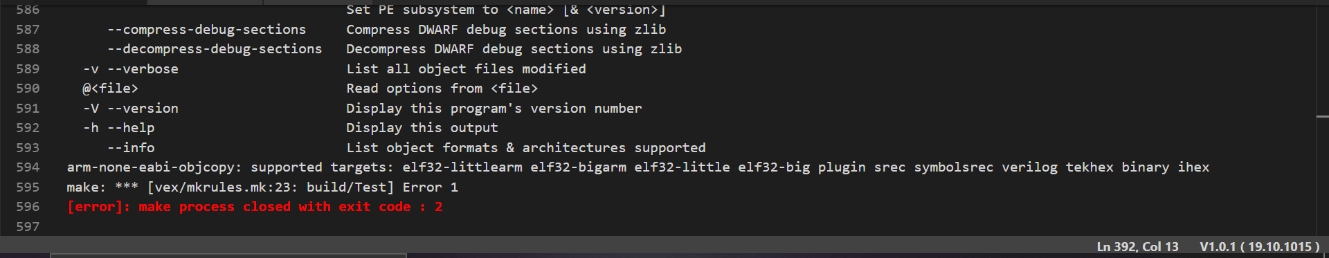

Solving Error - make process closed with exit code : 2
I recently programmed some new code for my robot but get this error message. Their is no errors in the actual code. I have tried re downloading vex code with the same error.Vex%20code%20error
Can you show the code?
Also the rest of the log please. The error is further up in there.
(side note, ’ make process closed with exit code : 2' just means ‘your code has errors’)

make: *** [vex/mkrules.mk:23: build/Test] Error 1
[error]: make process closed with exit code : 2
… interesting. You are right, the error doesn’t seem to be with your code.
It’s your project name, spaces are illegal characters in the project name. Replace them with dashes and you are all set.
Awesome i will try this thank you for the help. Surprised vex code lets me do that. This solved the problem
