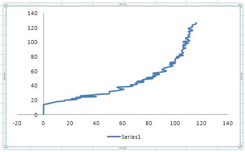

Updates:
Today I finally correctly set up the PID velocity control. Gotta say honestly that I have never read about or done anything related to PID velocity; I just know that PID velocity is I-P oriented and that it is done similarly as PID target.
So the way I do it is that I calculate velocity with 10 hz precision, which is a very very slow update rate, and the updating is almost perceptible. But this is the best resolution one can possibly get with a 360 ticks per revolution big red encoder directly attached to a high torque 269 motor.
Not sure if this is the normal way to go, but I figure as this is joystick control integrated PID velocity, I would need to make the joystick value the velocity target, scaling down from 127 to 100 rpm, and then use an algorithm to approximate the “seemingly right” motor value, and then use PID velocity to tweak around it. Which means, from the testing data, we need to find an algorithm that converts target velocity to approximated motor value, which is the inverse scatter plot regression of the previous image:
https://vexforum.com/attachment.php?attachmentid=9310&stc=1&d=1431111182
So, not knowing how to do quadratic regression, actually I should have used an exponential regression, which I will try later, I picked three pairs of values that look about right to calculate a quadratic curve that somehow approximates the scatterplot:
expected = (1/200)*target*target+(7/100)*target+14;
And I think I do need a deadband of joystick in the future, but now the calculating algorithm looks like this:

And with this rpm target to approximation value with a crappy quadratic regression, I did make the PID loop run:
float VelocityPIDOutput;
int Vtarget;
task PIDvelocity ()
	float Kp = 4;
	float Ki = 2;
	int lastPosition;
	int error;
	float proportion;
	float integral;
	while (true)
		velocity = lastPosition - nMotorEncoder[m];
		lastPosition = nMotorEncoder[m];
		error = Vtarget - (velocity)/6;
		proportion = Kp*error;
		integral = error + integral;
		if (Vtarget == 0)
			integral = 0;
		VelocityPIDOutput = proportion+Ki*integral+PIDVelocityBaseValue(Vtarget);
		wait1Msec(100);
So it does feel different and smooth with PID velocity integrated joystick control. You can see that I had neither time or idea about how to tune the two constants, so the set of data I printed out barely at the end of class looks pretty bad. Some significant overshoot is observed.
So, I will keep working on this project and adding stuff to it. After I get the tuning nailed I will start writing debug stream automatically printing rerun code program.
I figure VRC community needs some more PID velocity knowledge. Skyrise taught us lifts, needle intakes and PID target well. NBN is a game of crazy transmission, pushing, tracking program and flywheel struggle with precision, so I thought I should do some simple, basic starter stuff with PID velocity (so simple that it involves basically no case statements and my personal first ever function with parameter) and get us more involved and be like, oh, I understand what NBN world champions did with their flywheels, in the future.
Please criticize and offer improvement ideas to my programming! Full program up to this point attached below. Apologize for 0 comments; just trying to save time.
