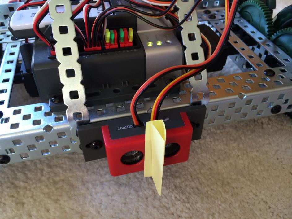

The fix I found was to put a Post-It in between the emitter and detector. I’ve attached a photo. After I did this, it worked just fine.
I’d really love a different solution (i.e. more robust), since a Post-It is unlikely to survive the rigors of competition even if it were competition legal.
Thoughts?

In the photo it looks somewhat close to the floor. Any chance it might work better if lifted a little or use washers or something to help tilt the sensor up slightly?
Also, have you tried to run it on something other than a carpeted floor? I know it’s summer, but maybe some static electric charge could be building up on that carpet??? In the winter, these robots can build up quite a bit of charge even on the field pads. Just a thought.
So is the problem specific to one sensor? Seems like it must be damaged in some way, I’ve never had a problem, mounting position shouldn’t be a problem. I’ve often mounted them that low (well, not quite that low), for example.
I would like to get a scope on the signals to see what’s going on, any chance you are near Los Angeles?
Do you have this same problem if the sensor is not screwed onto a frame? Looking at your photo again, I’m wondering if the way you have it mounted might be warping the grey plastic frame of the sensor, perhaps causing some kind of internal misdirection of the ultrasound beam.
If so, perhaps try putting some washers behind the sensor where the mounting screws are located so that the sensor frame can’t be warped when you tighten the screws. I’m just thinking out loud.
The beam should be wide enough to avoid problems caused by sensor misalignment, but this is also what came to my mind first…
The devices are so simple that I would be very surprised if it were a hardware problem (caused by damage, but I could believe a manufacturing issue). Definitely try it with no other sensors plugged into the Cortex to rule out an interrupt interference problem. If you’ve got another ultrasonic, try that one as well to rule our a Cortex hardware problem or a software problem.

Sounds like you should contact VEX tech support if these are new parts.
I’m about an hour away from there in the Glendale/Pasadena area. Are you running the programming course at a school or as part of a summer camp? Is this connected with a VEX team?
I was starting to think that myself. I’m glad I had a chance to discuss it with the group and make sure it wasn’t something I was doing.
I’m teaching the class as part of a summer camp for my wife’s non-profit. This is our first Vex class. (We’ve been doing LEGO NXT and EV3 for many years)
My schedule is pretty full between now and the class (18-20). There’s a possibility I could drop by your place on Saturday the 23rd if that works. PM me to work details.
Terry
I just exchanged emails with Eli in support.
He says that this is a known failure mode, but is very rare. Guess I got lucky to get 2 bad sensors in a single order. :slight_smile:
He’s going to swap both sensors for new ones.
Thanks to everyone for the discussion and troubleshooting help.
