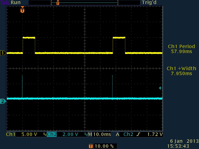

No official way and the unofficial way is unreliable.
The Ultrasonic sensor is polled approximately 20 times per second but varies depending on the distance.
The ping is initiated, the receiver will wait up to about 36mS for a reply, there is a delay of 50mS before the next ping.
Here is the sonar detecting an object about 130cm away. The blue trace is the output ping, the yellow trace goes low when the reply is received.
Here is the sonar failing to detect a reply.
So one way of monitoring the sonar status would be to monitor the IO port for the received signal and check to see if is high or low, there are no specific ROBOTC commands to do this but it can be done, not going to go into how on the forums though. It does not work well for objects that are close but the assumption here would be that data is valid, probably just as easy to monitor the raw sonar data and detect changes.
