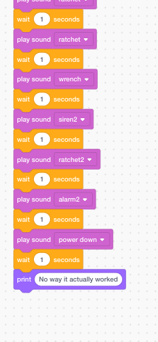

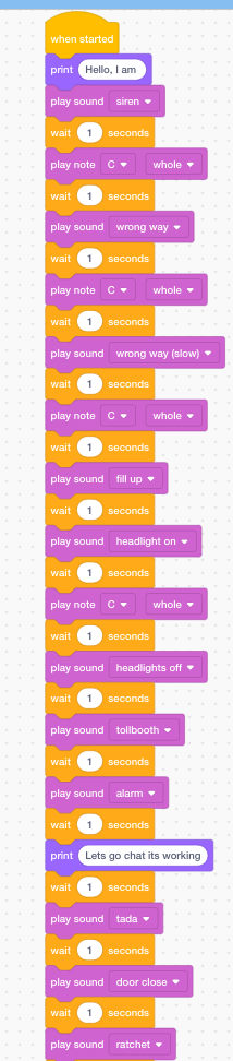

I was testing the sounds on my Robot Brain and on VEXcode, I put a list of 8 sounds my Robot should play but it only played the first two and the last. Also, when I programmed it to print a message, I didnt see the message appear on the screen of the robot brain.

Thats not the problem, upon further troubleshooting, I discovered that my brain can only play three sounds… siren, tada and one other sound that i cannot identify…
what do you think could be the problem
nobody will be able to help you farther without your code.
Did you try it exactly as I did it above?
yes, exactly the same way

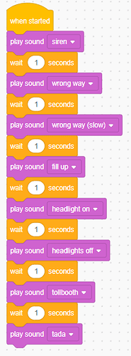

I just recreated your code exactly as you have it above and it seems to work fine.
Can you post a video of what your Brain is doing when you run this code?
This is the VEXCode file I used that recreates your code. Try this too:
