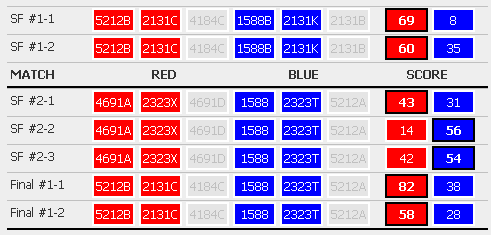

Just snapped a pic of match results. I wonder how they got 58 in the second final. Any issue happpened?
https://vexforum.com/attachment.php?attachmentid=8826&stc=1&d=1418994576
Edit: Comp URL Top of Utah VEX Competition : Robot Events
3rd alliance partner probably not as good…that would be my assumption.
Our 3rd pick wasn’t the best choice on my part and it was just a bad run. I think we ended up with 3 or 4 cubes on a 5 tall and a few cubes on the posts. I wasn’t really in it that day.
