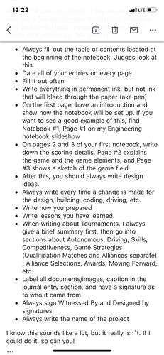

Hello, I was the notebook writer for my team this season and wrote 4 notebooks this season! We’ve won Innovate, Excellence, and Design Awards this season!
Here are my tips to you based off of experience this was only my 2nd season going into my 3rd next year)
