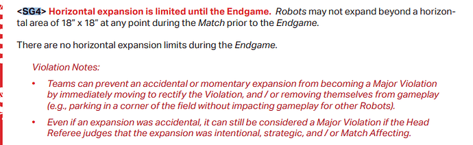

Our intake uses a chain and flaps to carry the discs, which does not exceed 18" in certain orientations, but can “expand” past 18" when it rolls. Would this DQ our robot?
I would recommend checking the game manual, specifically SG4.
Unfortunately, I do not believe this is legal.
https://content.vexrobotics.com/docs/2022-2023/vrc-spin-up/VRC-SpinUp-GameManual-2.0.pdf
No guessing (or belief) required, it clearly violates SG4, and your robot will not pass inspection.
While it may seem trivial to make a distinction, it’s not a DQ to be in violation of inspection, as that is a different kind of penalty spelled out specifically in the game manual under rule T13. If you receive a DQ, you get no points during the match. On the other hand, if your robot is removed for an inspection violation, a team member may remain at the field and your team will still receive the match result, per R3, c, i.

If your robot starts in a position that is within frame perimeter each time, you are fine. So if you need to rotate the flaps to be in frame perimeter prior to autonomous you need to do that. You will also need to do that for inspection. Think about all the bots that have mechanisms that fall down to make the bot bigger after the start of autonomous, they are fine as long as they are within the size limit at the start.
This is straight up wrong. If you expand beyond the 18 inch box after the match start before endgame, you are breaking the rule.
This rule is not applicable to this season, per the game manual. That has been a rule in previous seasons, but not this season.

For Spin Up, there is ZERO horizontal expansion beyond 18x18 allowed before endgame. If your bot is smaller and extends out to the 18-inch limit, you should be fine. We had a tournament recently where several robots failed inspection and required modifications because their intakes were outside 18x18 during their intake cycles. Which is a violation because the expansion is being used to manipulate discs.
Vertical extension is another matter, but it’s not part of this particular discussion.
