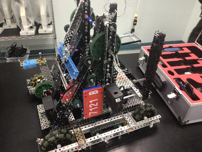

Considering how our robot never broke once in the entirety of the year, had extremely low friction on all wheels, had a more powerful hook than basically any competition (we could steal goals extremely easily because of how strong it was, despite having contact in a very small location), and the fact that it was more durable than all of our sister teams robots (except E, their robot was very well built) I’d argue otherwise. And in the time since we’ve grown, and we built basically 90% of that robot before November of last year. this year we’re coming in hot.
