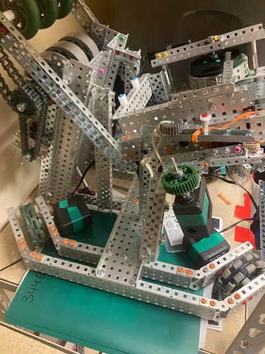

Here’s ours:
It’s kinda hard to see (sorry for the bad picture…the roller is on top left…) but ours is mounted onto the intake and chained to it.
When spinning the roller it stands about at the middle of the roller.
Honestly, as long as your mechanism makes good contact with the roller and has solid grip, it should still roll just fine
We run two controllers, and the second one frequently disconnects. So to combat this, our roller mech contacts just the bottom of it, so it can be used as a passive roller mech if needed. Ours is linked to the intake.
