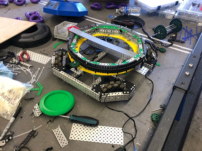

What are the differences between x-drive and mecanum, why did you decide to build a x-drive?
Also why go around the inside of the chain with plastic?
because I had(still have) 2 built
so there is a circle
