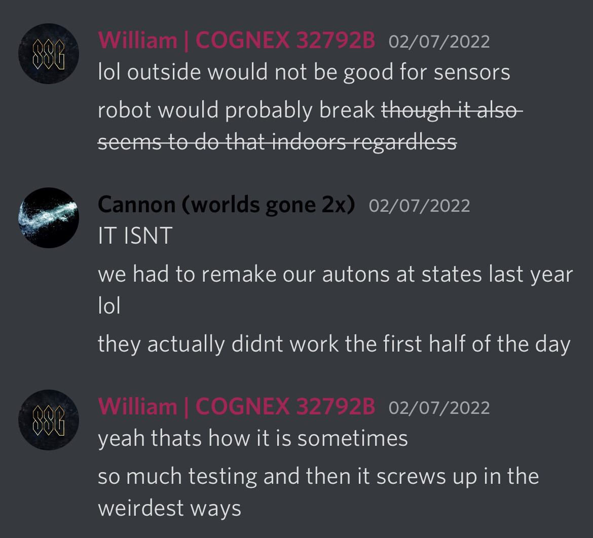

While its nice that your event partners were helpful in creating a sensor friendly environment, I also want to point out that in the past this hasn’t always necessarily been the case:
And last season at my region’s championship the red tent outside of the concessions building + the bright/variable lighting (due to the event being held outside) was enough to throw off teams’ autons:
So if any team is planning on using any light based sensors, just note that you should be flexible in your implementation to account for event lighting and environment variance. Not every event is going to have sensor friendly environments, and not every event partner is going to be able to (or willing to, as shown in the VF thread linked above), to change said environment to better suit the needs of competing teams.
