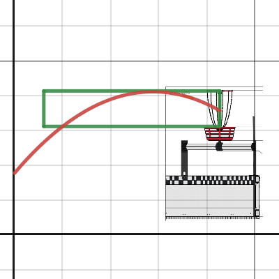

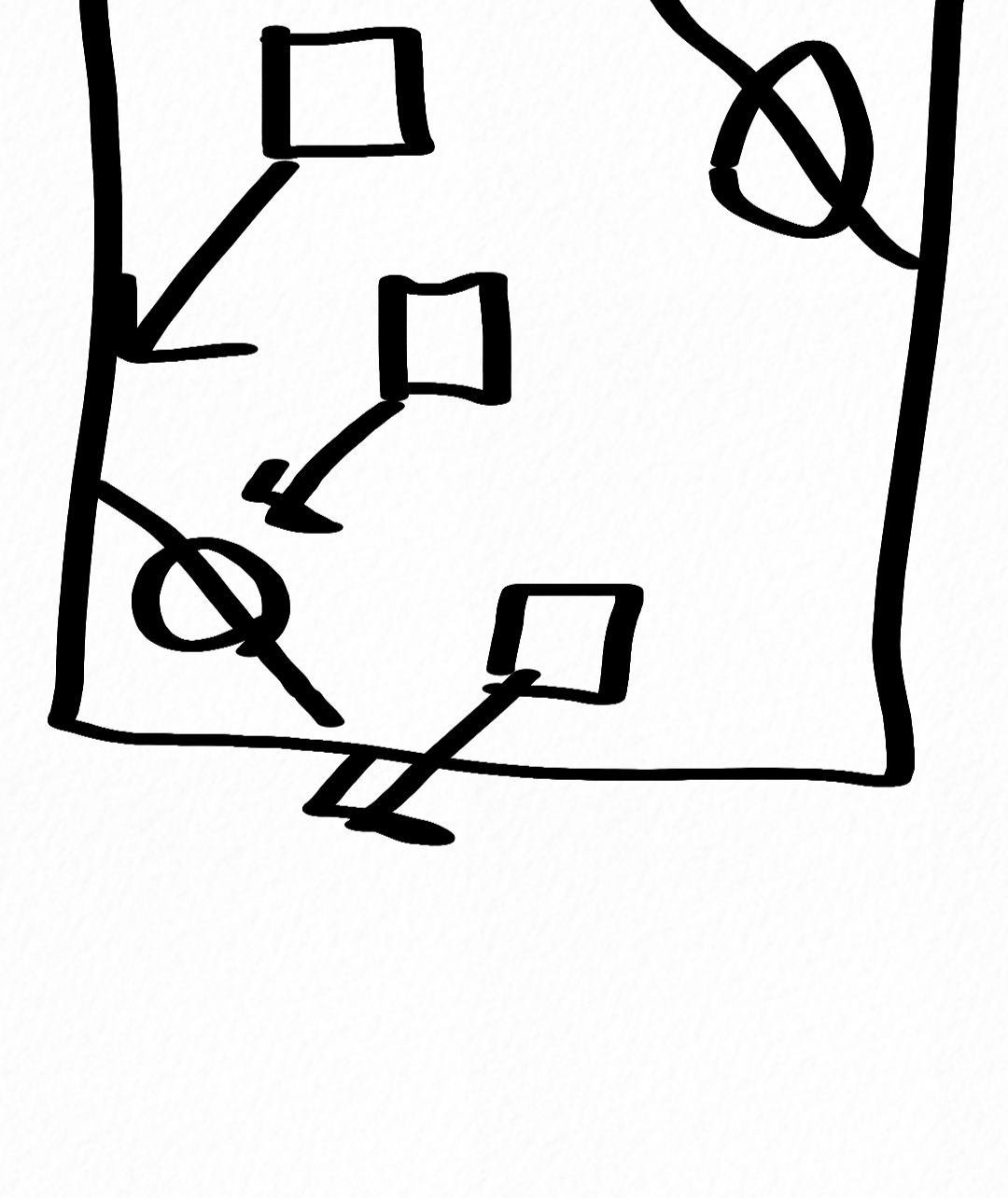

It wouldn’t face the goal at all times. It would always face one true direction, but it would only face the goal if the base is driven to the correct position on the field.
You can see here that if the turntable is set to hold southwest, it would only shoot into the goal if the robot is within a small area towards the middle of the field. This is where Odometry comes in to figure out where the robot is and adjust the aim accordingly

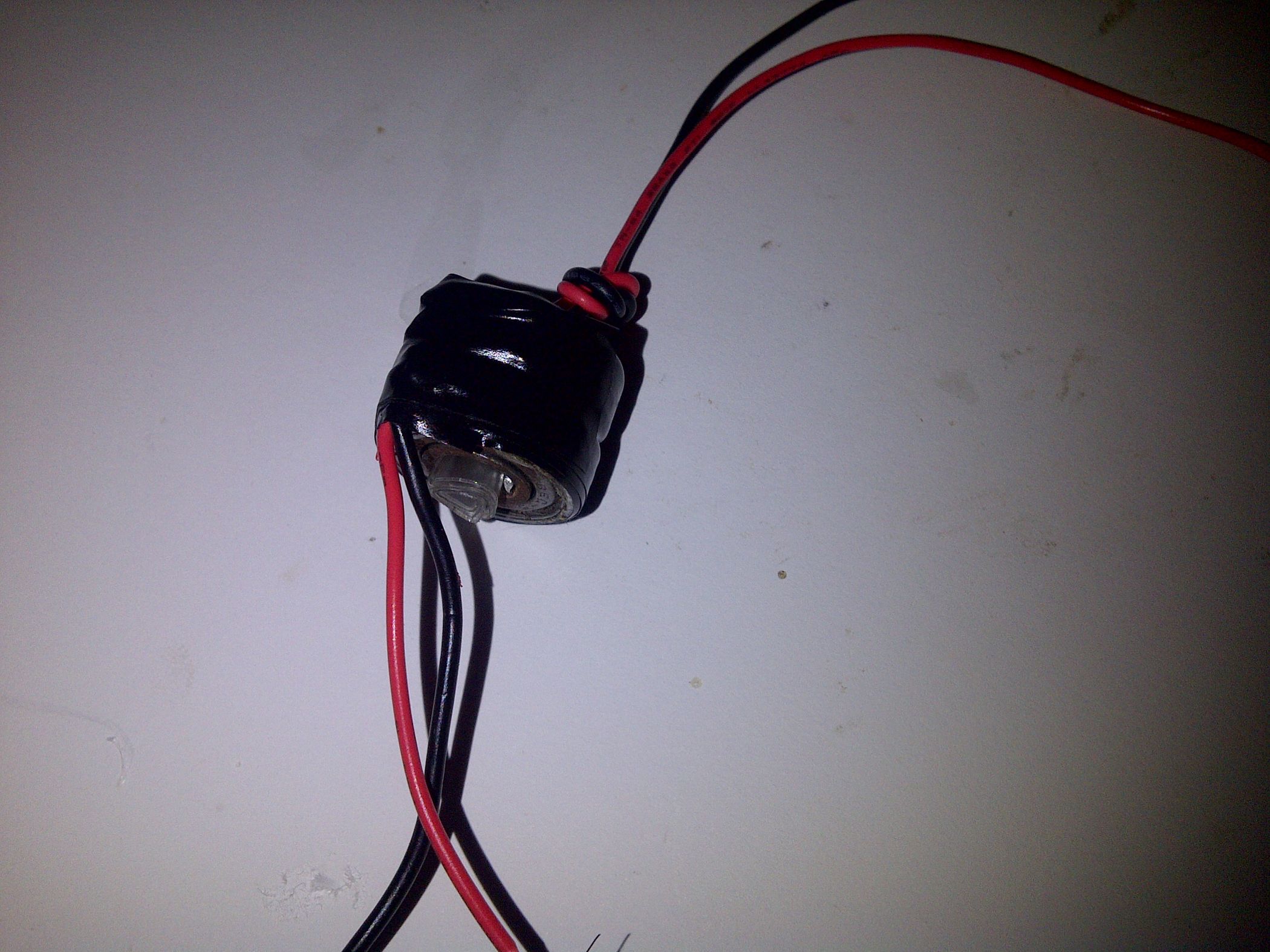

The answer to 360° rotation, so you don’t twist up your wires, is to use a ā€œslip ring connector.ā€ Unfortunately, this would only be legal in VEX-U, but if you’re interested anyway, here’s an example: Slip Ring with Flange - 22mm diameter, 6 wires, max 240V @ 2A : ID 736 : $14.95 : Adafruit Industries, Unique & fun DIY electronics and kits
what if one was to build it with only VEX legal parts?
I don’t know if the data will carry right, but I’m willing to try.

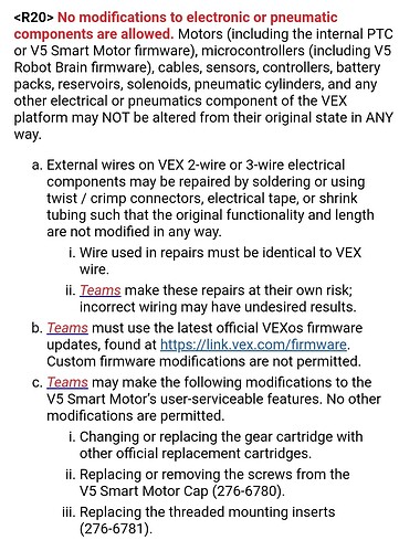

You can not modify electronics, even cables, only repairing them is permitted.
Dang it. Is there any possible way to do a slip ring then? I can’t think of much else…
Yes… You can graduate from high school and join a VEX-U team :slightly_smiling_face:
