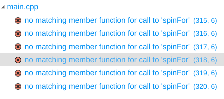

spinFor giving "no matching member function" error

Here is the error:
It is referring to the spinFors in the autonTurn function. The lines are exactly the same as the ones in the autonDrive function. Any ideas why this could be giving an error? I read the little documentation article and my lines are exactly how it should be.
you are re-using “degrees”, it’s a global in the vex namespace, don’t use it as a function parameter as well.
