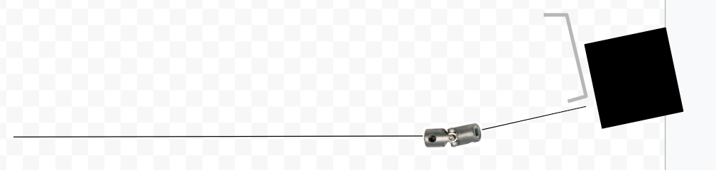

Maybe a universal joint would work. If you or your organization don’t have any, you can find them here on the VEX website - $11, VRC legal, and in stock!

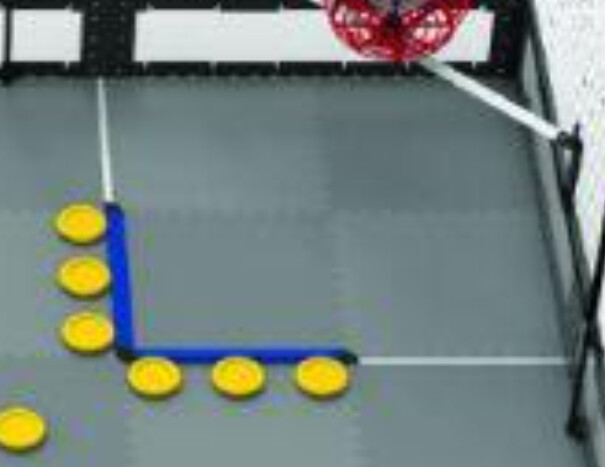

Edit: Watch out for these low goal barriers!!! They could potentially wreak havoc on low clearance mechanisms.
I will probably end up using 12t gears, theyre fairly small and should be fine as a pickup roller.
Those discs against the barrier will be fine, I have an idea for a workaround avoiding the barrier entirely, while still picking up those discs
