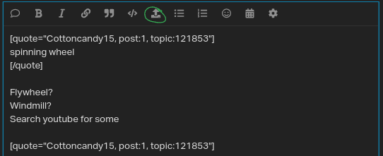

I am trying to attach a video or picture but it is not working?!

Screenshot 2024-02-08 11.56.36
This button. If you can’t, just attach a link to a google drive file (with link sharing on).

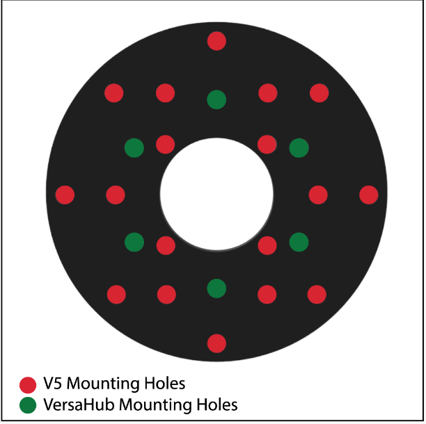

How do i use flywheel weights? (Where to put)

Judging from your previous posts, it looks like your flywheel (without the weight) is operating well.
However, for future reference:
Link to the product page:
V5 Flywheel Weight (2-pack) - VEX Robotics
To mount, use the red holes to connect it to your traction wheels
Flywheel weights make your launcher change speed slower (it’ll be harder to speed up, but once it does, it slows down less when a triball is launched, allowing you to matchload quicker).
More technical explanation
The flywheel weight adds more weight to the spinning thing, meaning it takes more energy to accelerate/decelerate it.
