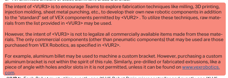

Would spring steel fall under point e?
Yes, as spring steel is still just steel.

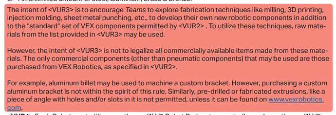

Given the note under the rule you quoted, I would say no. But best to ask on the official Q and A.
edit: Given the note under the rule you quoted, I would say YES. But best to ask on the official Q and A. I guess that I should have at least Googled spring steel. I assumed the spring was already made. If it is raw material, you’re good.
Spring steel as bought in raw stock appears to be totally legal. However, please post it as an official q&a, along with other questions you come up with regarding fabrication rules. They are an absolute mess and VEX/REC need to revamp them if they want university students to take the program seriously.
