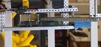

Okay, so I posted something a couple days ago about having trouble with our arm lifting crooked. The image is a picture of our gearbox (three motors on each side of the arm). It is a 7:1 gear ratio. The bottom of the c-channel is attached to the 84 tooth gear and the top is attached to a shaft using lock plates. Currently, when we run our motors, the lift is going extremely crooked. We have looked at the internal gearing and they are all the same. We added integrated encoders to all of our lift motors. Our next step was going to use PID control to stabilize our left. Is anyone else doing the same? If so, can I see the code, or just sample code? I’m honestly not sure where to start with this, any other suggestions would also be helpful

Yeah if I look at the picture closely one of the gears is shifted further down than the others. Could be missing a bearing entirely.
Try using spacers. You’re only using collars (I think some people call them shaft locks or something).
@AcidEpicice @vex2.0
This was an old picture, we noticed that too and fixed it. I probably should have mentioned that in the first place, but that is true, spacers could help. But does anyone have experience using PID? Any pointers?
