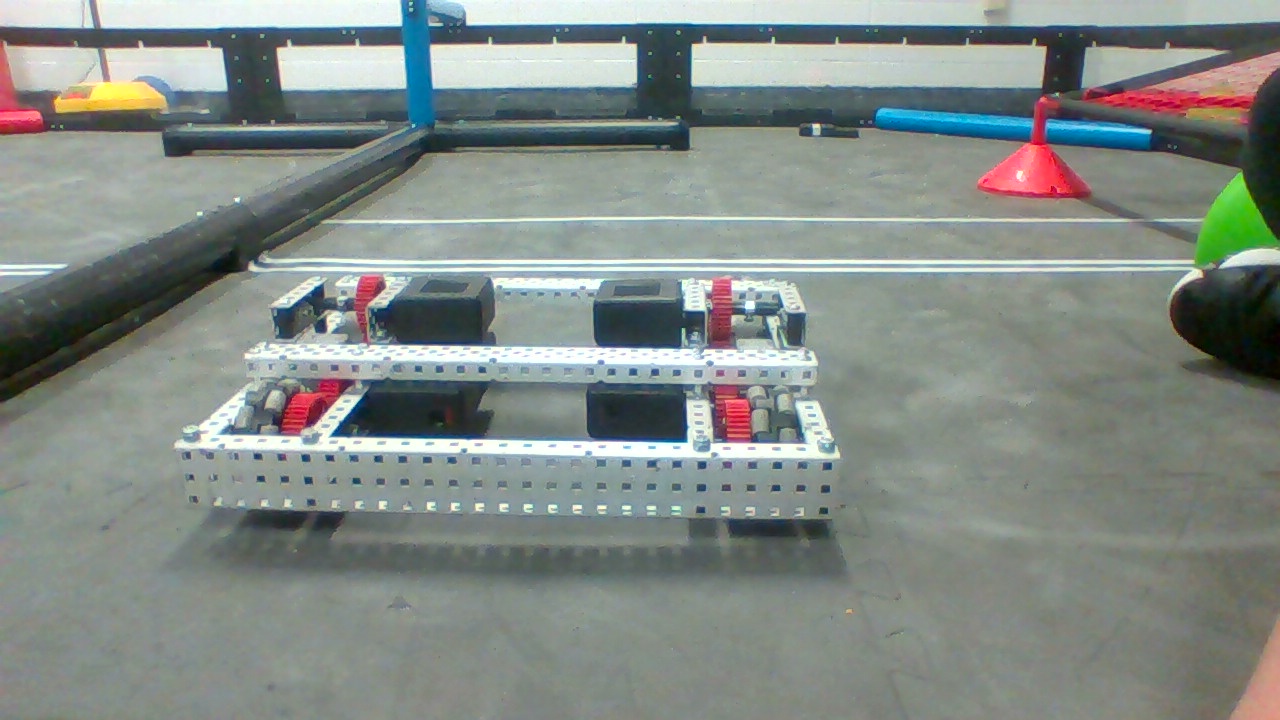

I stack my back 2 motors to save horizontal space. I use a 15x15 bot frame. If you use a larger frame, maybe you will not need to stack 'em.

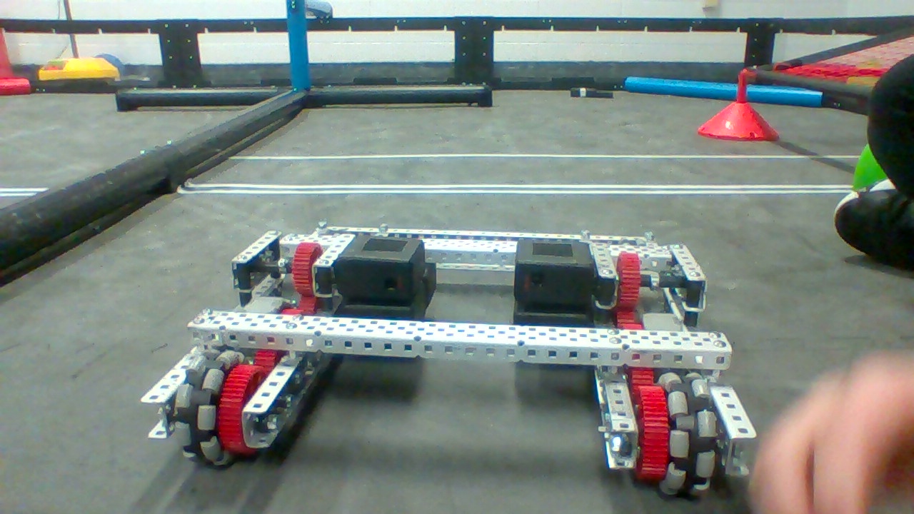

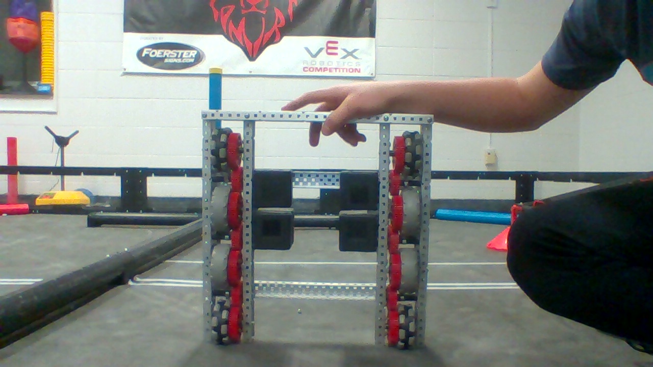

15 inches and yes, I use six 4 inch wheels. 15 holes is impossible in VRC. Or is it…
(Ignore the last wheel)
Don’t trap yourself into thinking linearly…

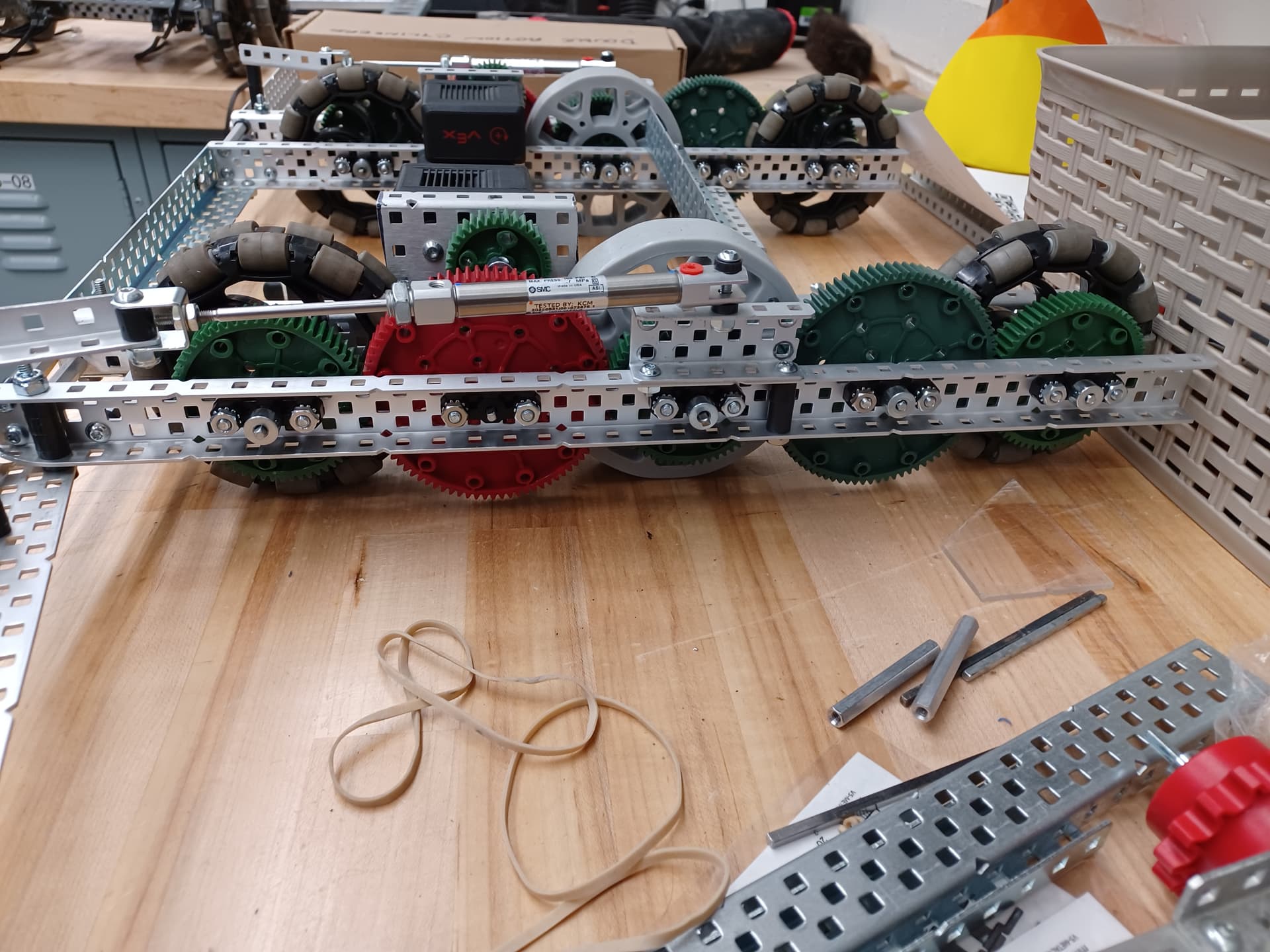

If you think that’s bad, try seeing my cursed robot…
I had to disassemble half the left side to swap out a dead motor :sweat_smile:
this adds a lot of weight to the robot, which probably counteracts against the “less sunk in” advantage of wheels
Stacking motors adds the weight equivalent of 1 35 hole c-channel plus a few screws and whanot. The extra weight, if built right, is negligible
theoretically yes, but usually you’ll add at least another 35 hole c channel, if not a HS cross bar, to give it structure on top, in addition to your usual bracing.
This question isn’t really that complicated, so I’m just going to boil it down to one sentence: Stacking takes up less space but is heavier
It isnt much heavier though. If you do it right it should add about 3 or 4 ounces to you robo
