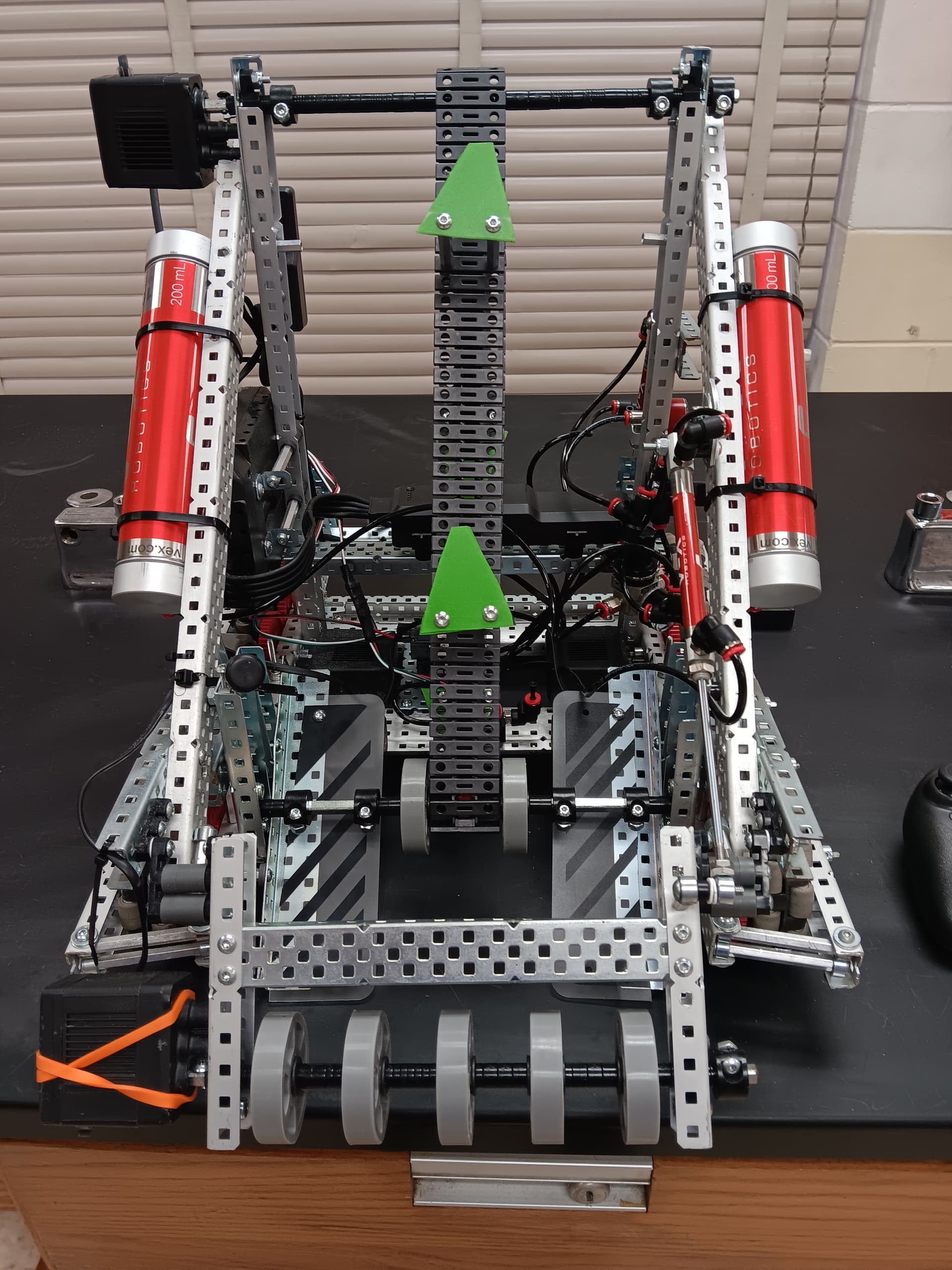

This is a picture of our intake and conveyor belt.
idk what motor cartridge you are using but if you are using the green (18:1 Cartridge (200 RPM))change it to the blue cartridge (6:1 Cartridge (600 RPM)).
If that doesn’t work It looks like your upper half has no bracing and your current bracing is the HS shaft. I recommend getting an l channel and placing it horizontally across both sides of the stage 2 intake below where your hooks run through. I also recomend for you to make the High strength shaft have only the spacers in the middle to hold the hook inplace and not cover the entire shaft.
Can you give me an example of what your talking about? We tried swapping out the green cartridges for the blue ones. Nothing changed. Thank you for your suggestions!

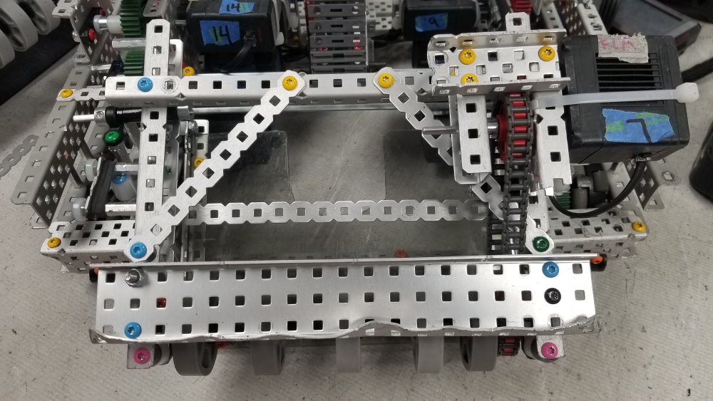

Here is a pic of our beater scrimmage bot. HD. Axle with HD bearing flats, 600rpm cartridge, 1:1 chain gearing.
Plenty of bracing (perhaps a bit overkill) to keep the axle aligned even during heavy bashing.
Remove your motor and make sure the axle and wheel combo spins absolutely freely. Then brace it up, checking every single step of the way that the axle continues to spin easily and freely. Tighten everything securely with nylock nuts. Check again for free spinning before adding the motor back in.
A 600rpm direct drive motor should be plenty fast, but go to your code and set the rpm to 100% to get the max speed out it.
I did this once… and it was because we forgot to change our motor code to blue cartridges and set velocity to 100%
Few pointers:
  1. 1x1 bars flex really easily, and are bad for bracing. Might want to swap those for 1x10x1 L-channels.
  2. Might want to box brace that front 1x3x1 c-channel
  3. You seem to have a lot of structure there, you could clean it up by taking out some c-channels and using standoffs, zip ties, polycarb, etc.
    Nice bot otherwise though!
