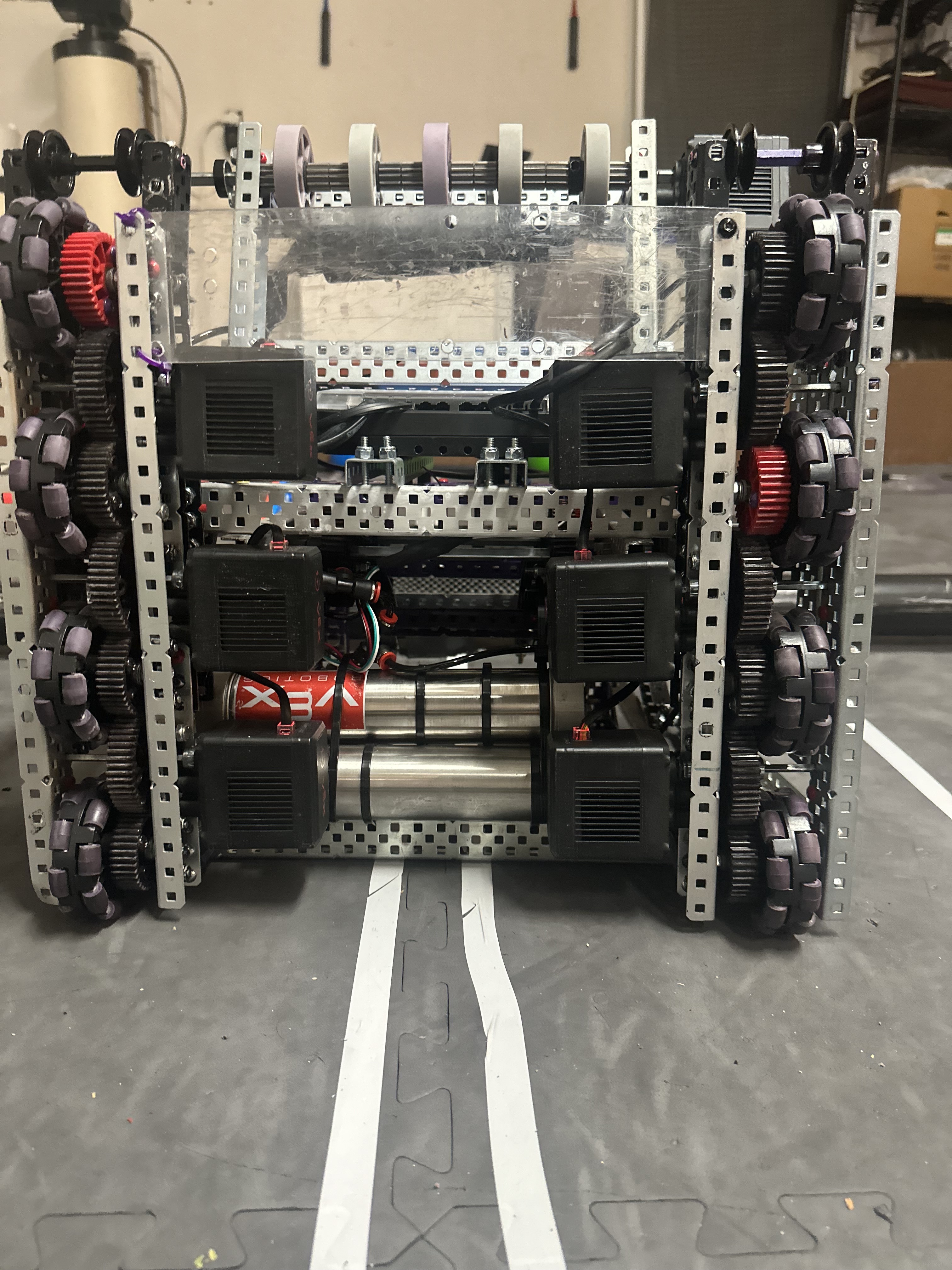

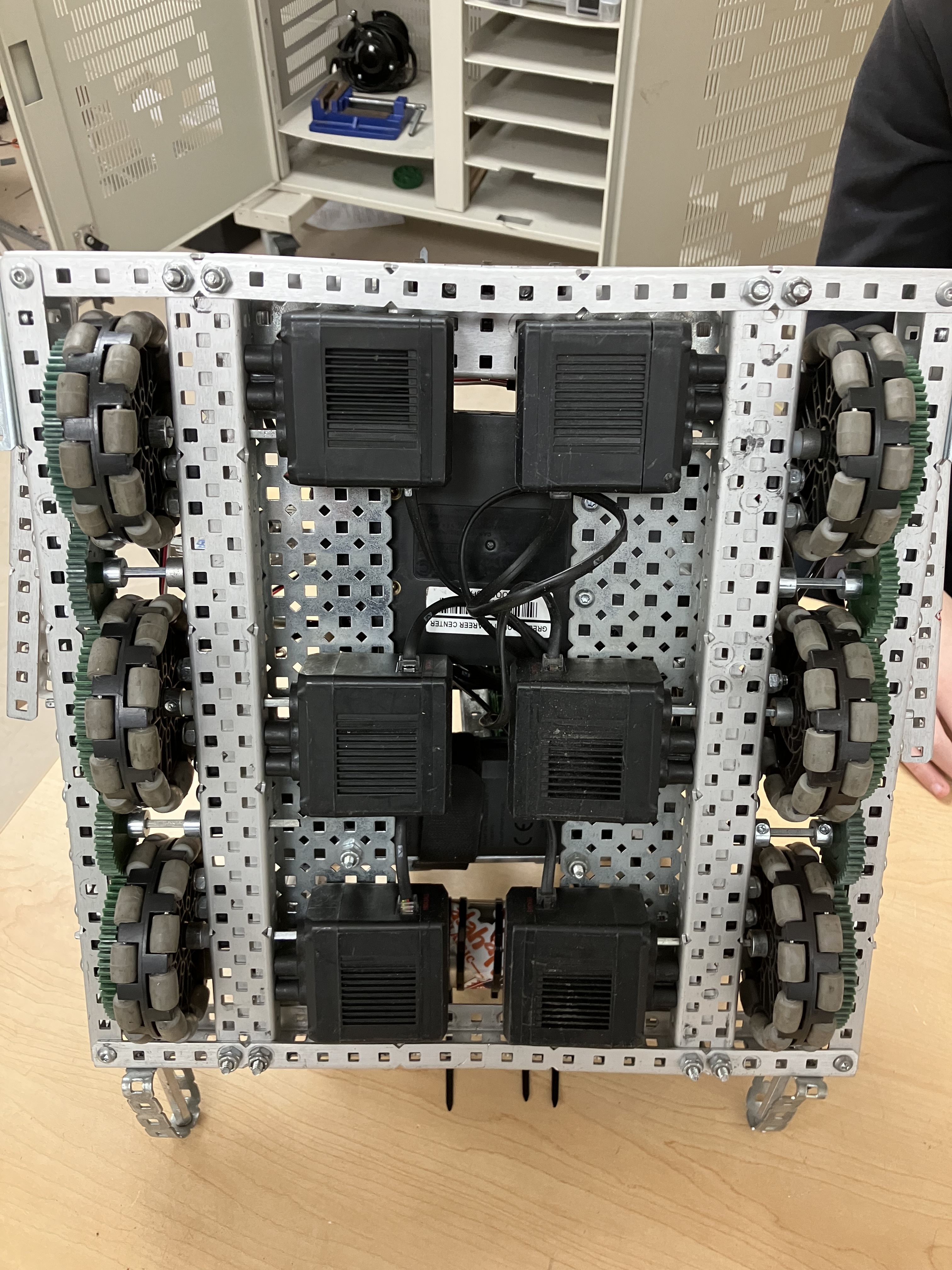

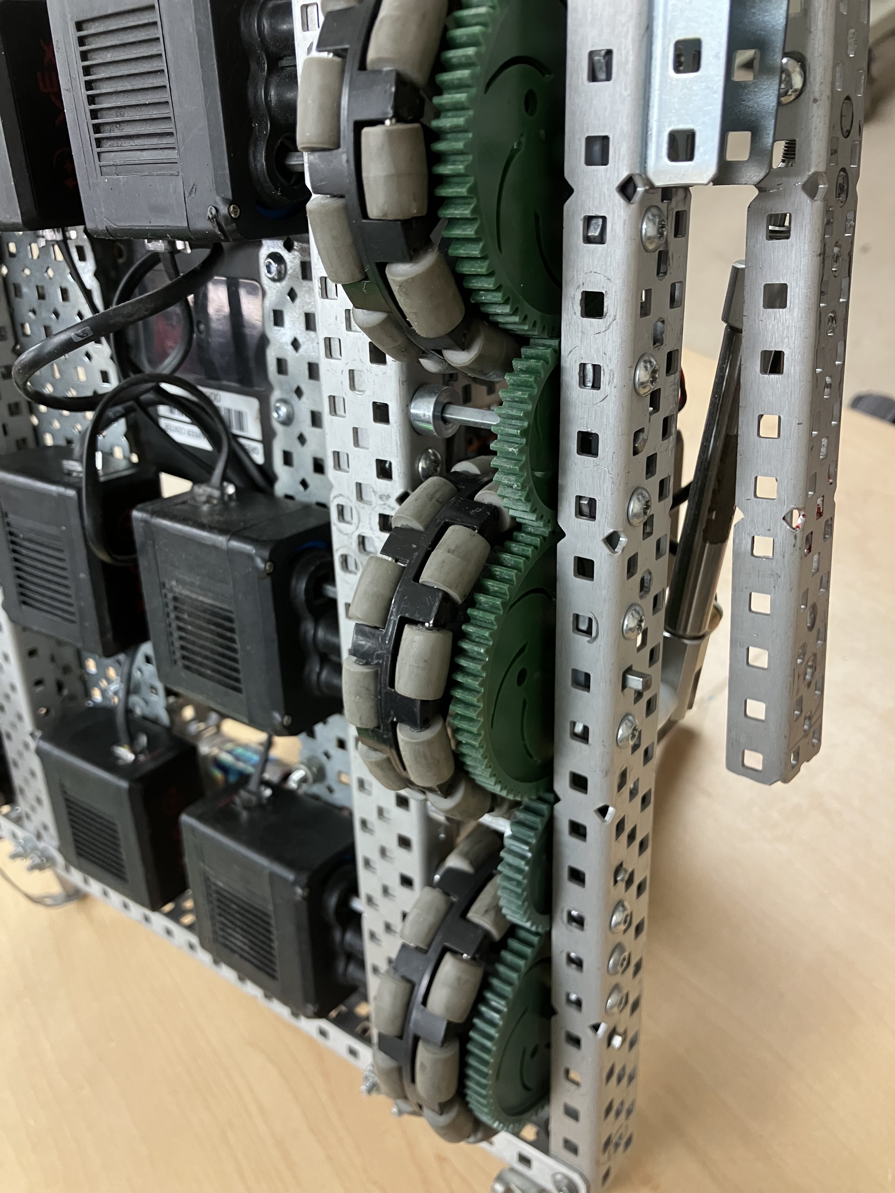

Here are some photos of our drivetrain, if you need to see a design of a 6-wheel drivetrain.
we’ve already done this in the first version of our robot but it was too heavy so it got stuck over the barrier
but with 3 4" omni and blue catridges
and I actually thought about this idea because we got stuck so often and tried so many things but we couldn’t make it so I was like : what if I don’t use anything in the middle and so the omniwheel in the front will just move until the barrier meets the second omniwheel that’ll slide over the barrier

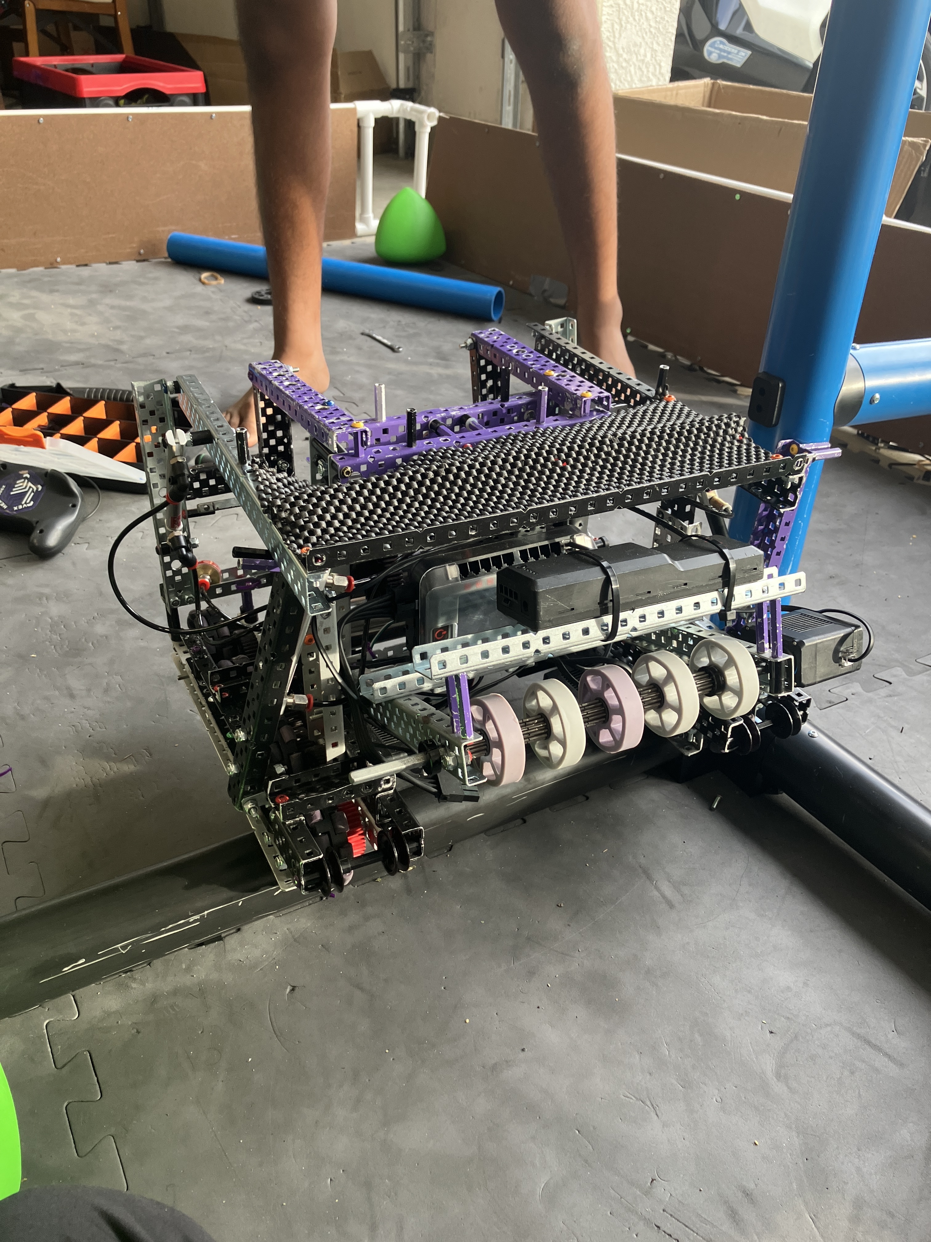

We use both. The pulleys are mounted in front of our chassis as sleds so its easier to climb.
can u show me a picture
Sure I’ll see if I have a close up of it.
A picture of your robot’s drivetrain and another of it trying to go over the barrier would be greatly appreciated, but going off of what you said, here are some tips:
  1. Re-distribute the weight on your robot more evenly (move your pneumatics tanks/mechanisms around)
  2. Use a flex wheel for the center wheel and make a gear train to power it
  3. Use less steep barrier sleds, or attatch a small 2in flex wheel connected to the drivetrain by chains at the front of your robot where barrier sleds would go
  4. Gear down your drivetrain
For more specific tips or recommendations, a thorough description of why your robot isn’t going over the barrier (like “robot tips backwards”, “gets stuck between 1st and center wheel”, or “not even going on top of the barrier”) and images of your robot would greatly help us help you.
