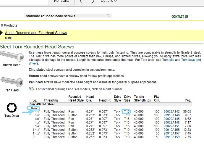

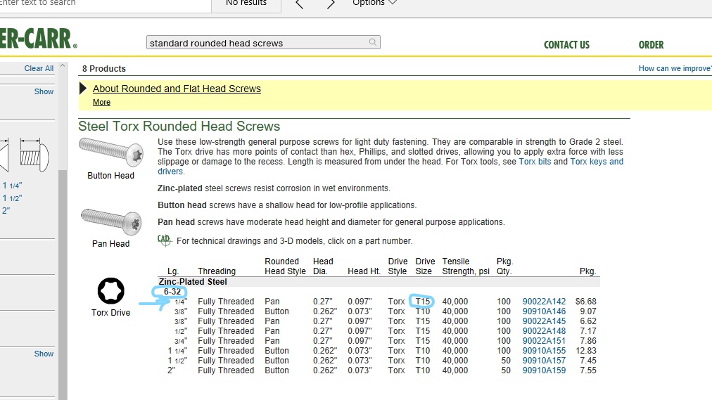

Whoops, I think I read your post wrong, I thought you said that you found 6-32 setscrews with a T15 head.
Nope, unfortunately not. And the shaft collar set screws are 8-32 x 1/8", so I am looking for those with any kind of star drive/torx head.
Vex sells the motor screws in 1/4" and 1/2" lengths so those would seem to be appropriate.
I actually did find these. Since I can’t attach the link to the search itself, I’ll attach a screenshot. You just search up the same thing that @dgebhart recommended.
