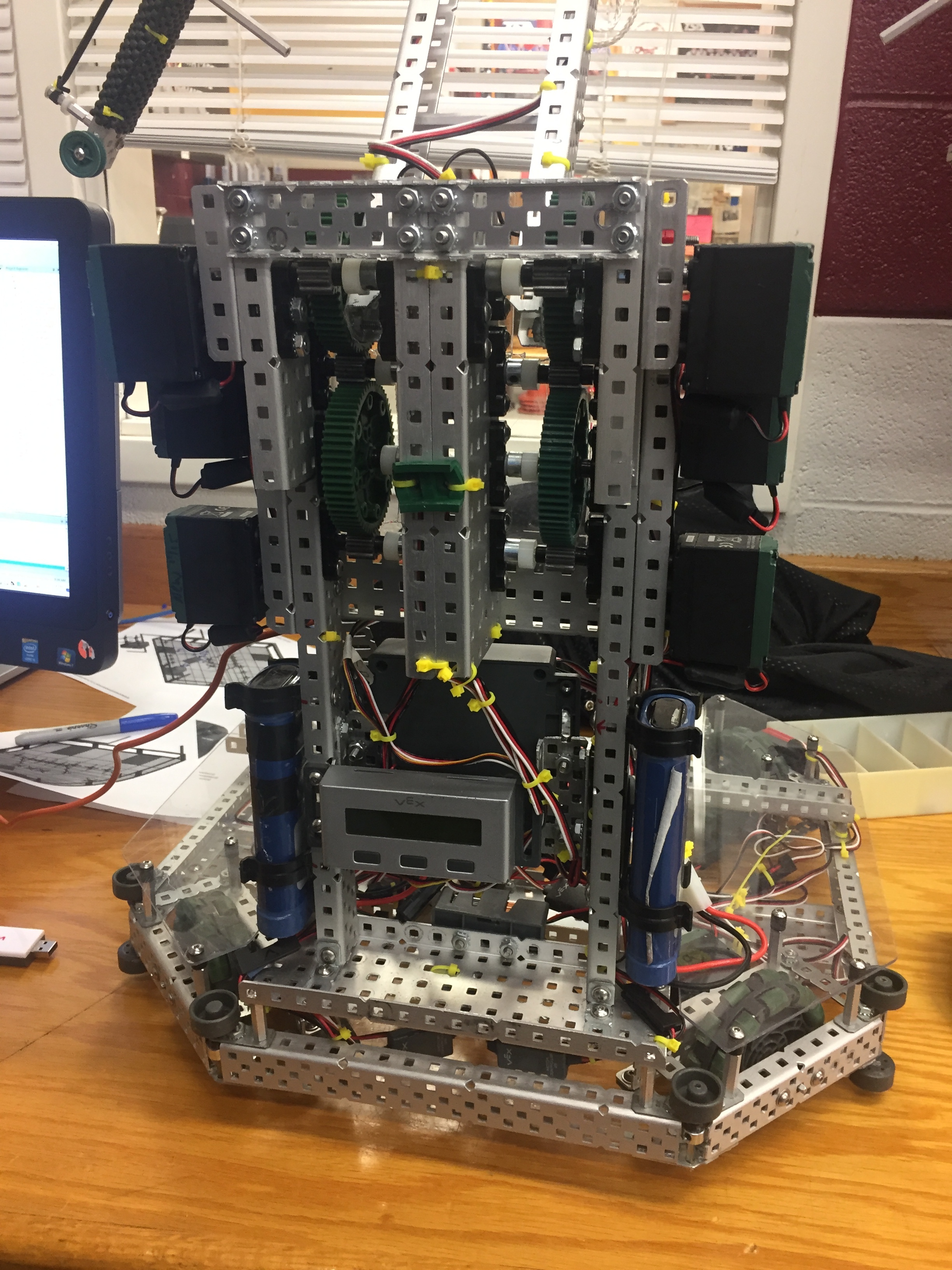

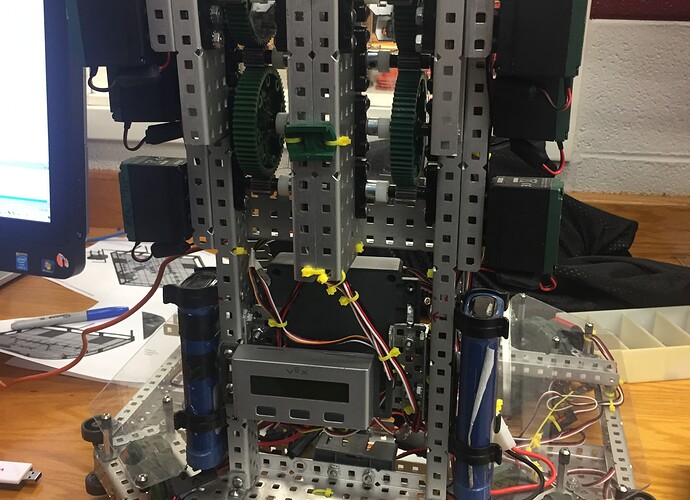

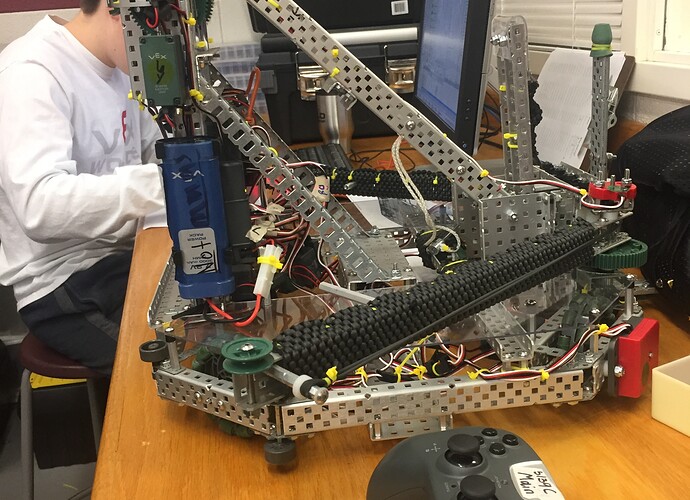

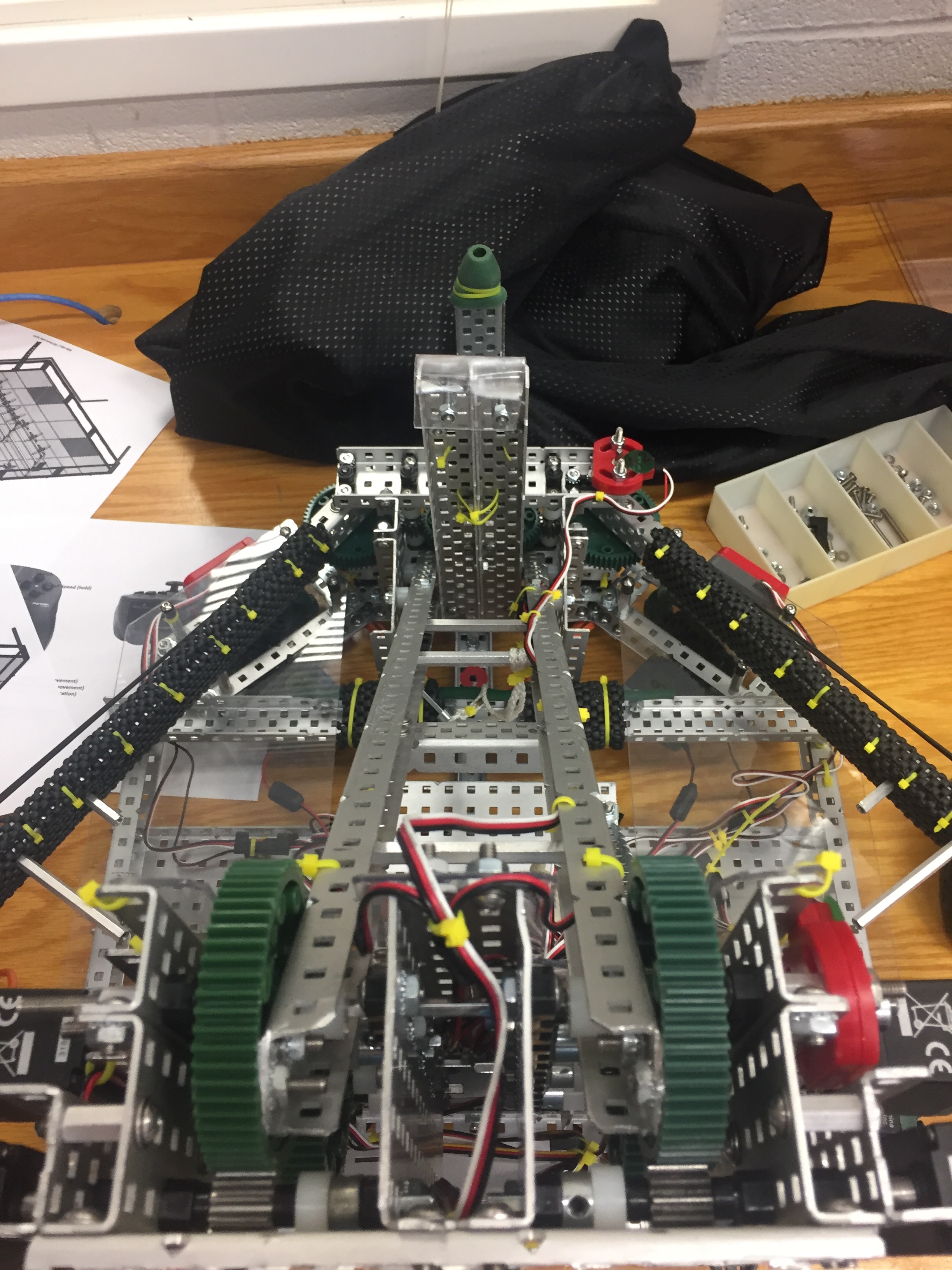

My robot is cutting out from static it’s not disconnecting it has all green lights on cortex, battery expander, and both controllers were working (were running tandem controller). We have a holonomic drive train (HS motors) with shaft encoders on two of the 4 holonomic drive train motors. with six motors (all HT motors) on our gear tower lift mechanism with a potentiometer on the final shaft. Then we have a 2 claw motors (HT motor) with a potentiometer on one. Plus we have an LCD on our robot. Could somebody help us figure out why were cutting out but not actually disconnecting.

Here are pictures of our robot
Is it just certain motors that are overheating i.e. lift motors, drive motors? Right off the bat i can’t see any obvious spots with extra friction.

It does look like those gray wheels/claw motors on your base/claw may drag on the competition mat. If they do then you need to move them so that they don’t cause static buildup while driving.

It may not be a bad idea to move those gray wheels (they’re there to align our robot against the pole for Hanging). As for the firmware, the cortex, keys, and controller are new and the firmware was updated as of yesterday. Thanks for the suggestions though!
You don’t need to move them though unless they are dragging on the mat. Same thing with your claw motors.
The only time the grey wheels are touching the mat is when the robot tips when it is delivering stars and cubes and for the hang
And the robot isn’t moving at that point
Well then that’s not the problem. In that case your best bet would probably be static.

Your drive train is being asked to do much work, and it is tripping the PTCs. Your symptoms are not typical of a static problem. Try changing the motor gears to the 100 rpm gears and see what happens. I believe that there is about a 98% chance of one of two things being your problem:
  1. You have too much friction in your drive.
  1. Your effective final drive ratio (internal gearing + external gearing + wheel size) is too aggressive, overheating your motors. Remember that holonomic drives generally place a higher load on the motors than a tank drive layout.
