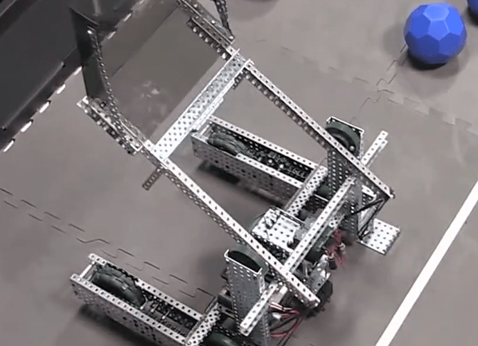

My current launcher concept is a tray catapult. Essentially, it will be a wide flat panel with small edges that will contain several scoring objects. I plan on using a large slip gear to fire and reload the catapult.
I dont know if anybody has seen this yet but I think it is almost the exact thing I want to do, except with forklift prongs instead of a scoop.
Really amazing idea! In my opinion, that would be one of the best builds if you can make it happen.
