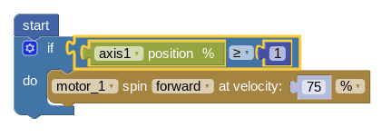

blocks has pre-programmed ‘blocks’ of code that you can mix and match, the text is c++ or python depending on your syntax preference. I use c++ text and I am able to easily transfer blocks to text as its similar to regular sentences
i.e.
if(Controller1.Axis1.value() >= 1){
motor1.spin(forward, 75, percent);
i basically told it that if axis 1 on the controller is more or equal to 1 then it turns the motor forward/clockwise at 75% of the maximum speed
this is it converted to blocks
Screenshot 2021-01-12 at 12.29.40 PM
