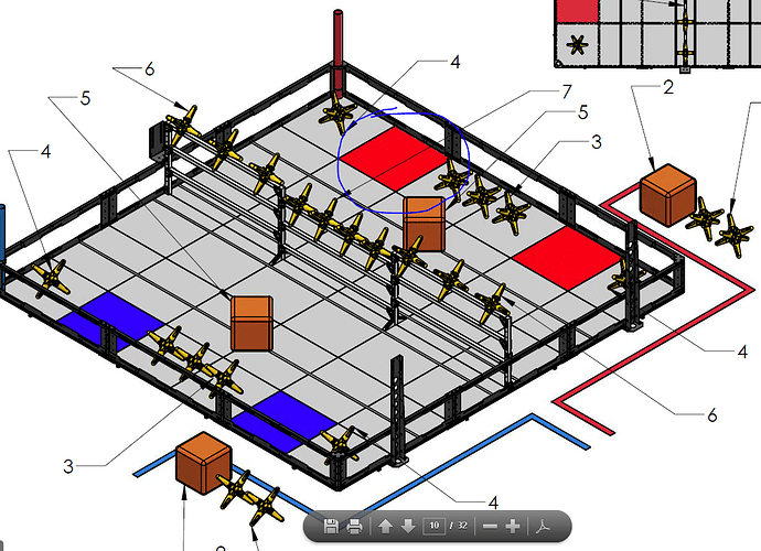

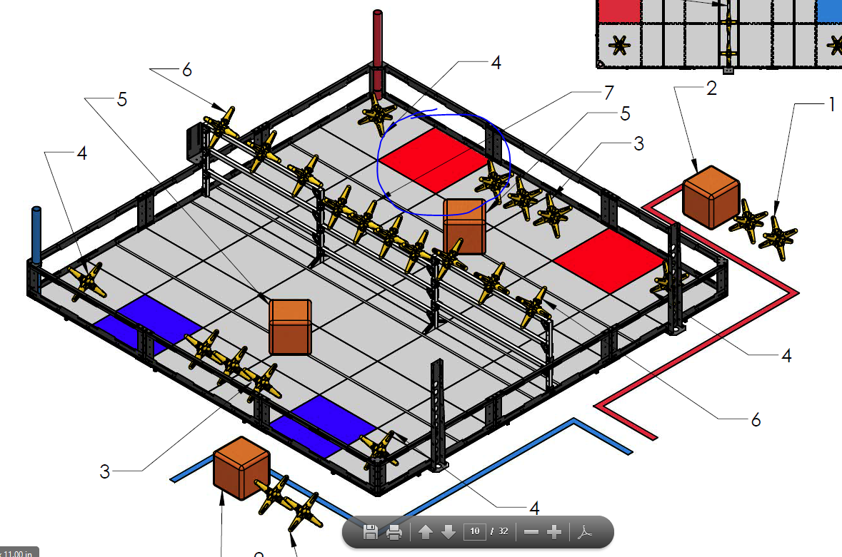

5 stars sit in the far scoring zones at the start of a match, does this mean that a match starts with a score of 10-10?
No, because there is also a cube that counts as being in the far zone, and 2 preloads on each side in the far zone, so the game starts 18-18.
