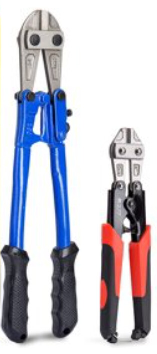

I am amazed at y’all!!! Bolt cutters are the way, the truth, the life! One snip, and it’s done! Sometimes it requires a little clean up with a disc/belt sander or file, but it’s that simple. Forget buying new discs and hacksaw blades, forget clamping your work piece down. I got one of these for 15 at a hardware store. You would need to buy a large one for high strength axles, but they still work great for those. The leverage these things give you are insane. The blunt, brute force is so addictive. These things are absolute bone crushers. If you’ve never seen these, you need to find a pair and give them a try.

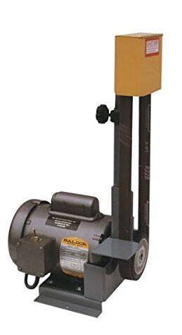

Have used those before. Not good for clean cuts in ‘c’ channel. And most don’t have a belt sander for cleanup. Cleanup via filing is gonna take some time.
We use bolt cutters and they’re amazing!!! We can cut all the shafts we need in minutes and we just use a belt sander and it makes them perfect!!

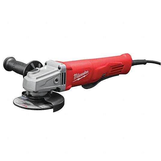

At our school we just use an angle grinder, more expensive but it cuts like butter and last forever. Sometimes you clean it up with a file but over all pretty good.
