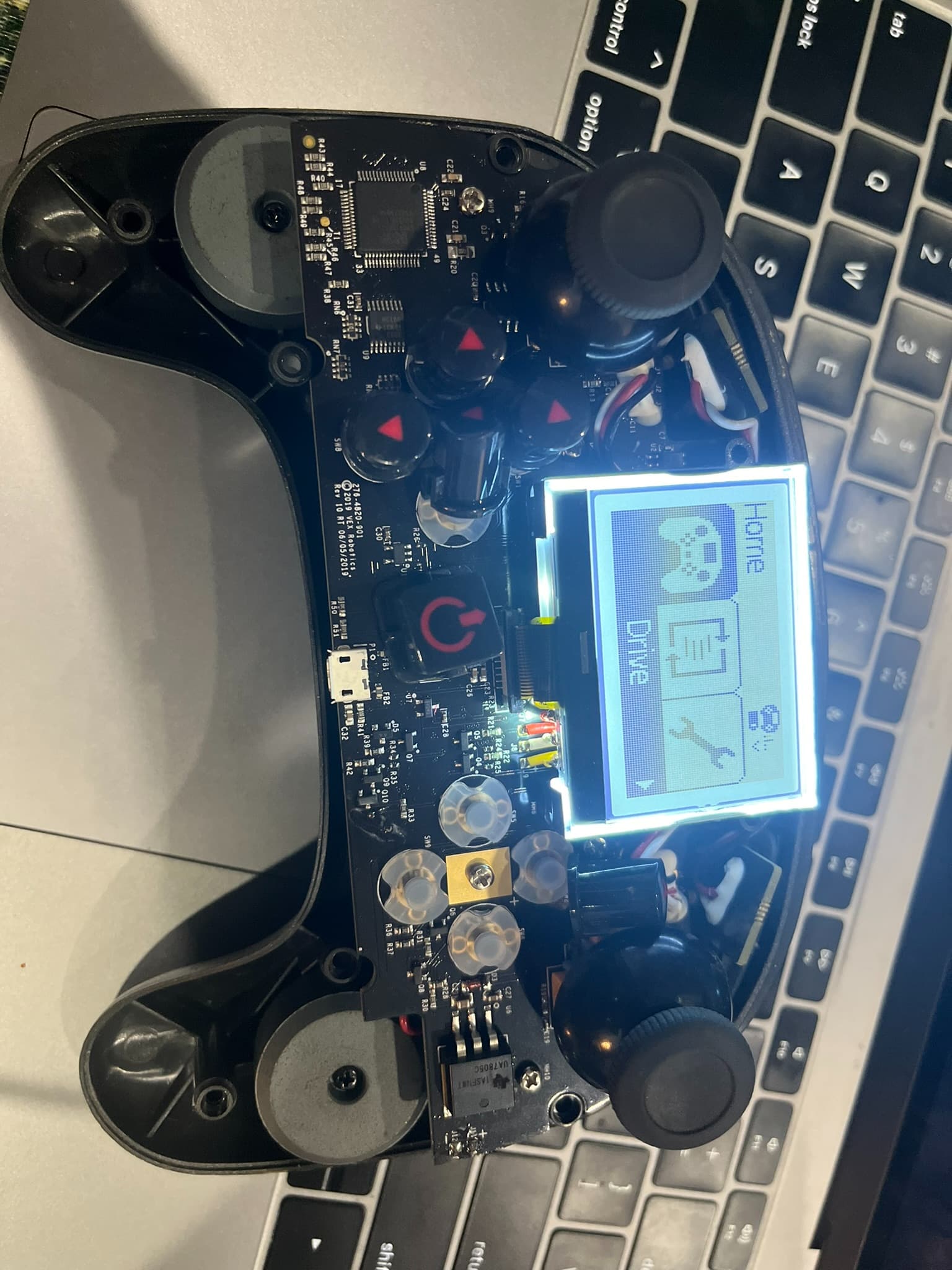

So i have seen some of the topics on this but they say to clean it and we haven’t really done anything to it which may make something get inside the crevice near the joystick but i shall still try it. This started today when we were practicing driver skills and the joystick some how got pulled up which made it “sticky” on all sides of the right joystick so I pushed it back down and it seemed fine but whenever we would make it go left or right it would stick
so is there something we should do to fix this without opening and cleaning the controller if not then ill try and clean it and if i do are electronic dust cleaners cans enough to clean it?
I wouldn’t trust canned dust cleaners, as those may push the contaminants into the controller (I’ve had that happen with keyboards).
In my opinion, your saftest bet would be to just open it up.
Do you know roughly what contaminants are causing the stick (spilled soda, metal shavings, hardware getting old, etc.)?
i would say metal shavings or dust in the box we have from the other pieces and robot wheels
I have opened/cleaned sticking controllers before. Then we banned food/snacks at the robot area.
Not hard to open. I would open it FACE DOWN. Otherwise the controller buttons will all fall out.
They are not that hard to open up and clean.
If a student spills soda into the joysticks, you really have to open it up and clean it with a soft, moist cloth (canned air is not going to help).
I agree that sugary drinks and controllers do NOT mix well…

the right joy stick is a bit tilted to the right while the one thats good (the left one) is straight up soo is that a problem with the product or bc smth got in it?
nvm i fixed it the pin inside of the joystick cover or whatever the joystick rubber part is called i just pulled that off and the pin inside was badly twisted and bent but we’ve never done anything that would have that happen so thats mostly what im confused on
