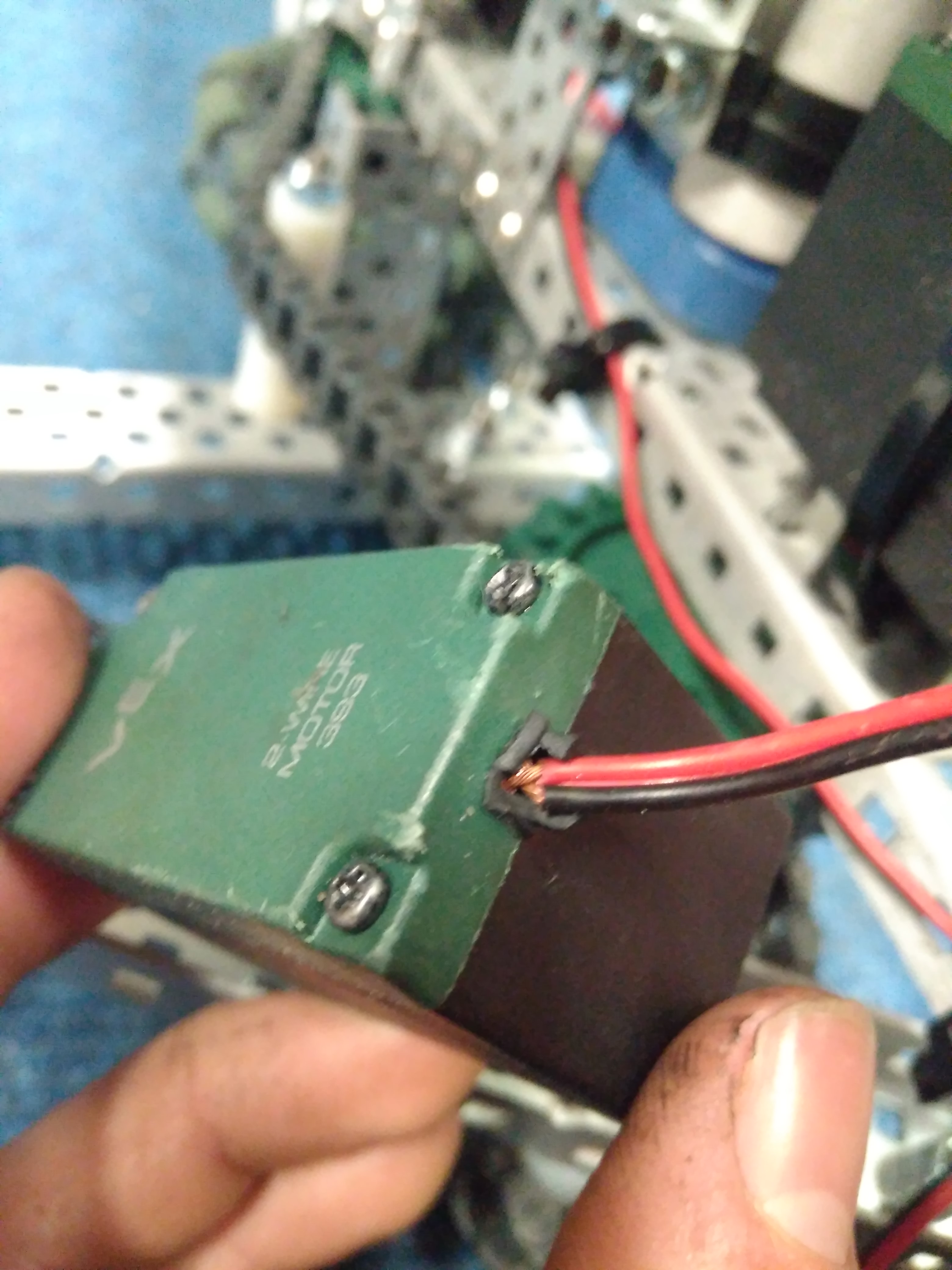

We had this problem recently and we found the problem was due to the wires in the back of the motor being exposed and touching. This meant that the motor was acting as a generator when being twisted and would power itself to resist motion. @8232X explains this in better detail above.
When you say the back of the motor - is that inside the housing? We have had a few motors that did this sort of thing as well, and they all looked good in terms of wiring from the housing out to the plug. We also had one that ended up frying several motor controllers before we realized the motor must have been shorting inside (by deduction). Is there a way to check those interior wires and possibly repair them?
@TeamTX when I said back of the motor I was referring to something like this (picture below). So far we haven’t had any shorting inside the actual motor, it seems most of ours come from wires being pulled to tightly.
