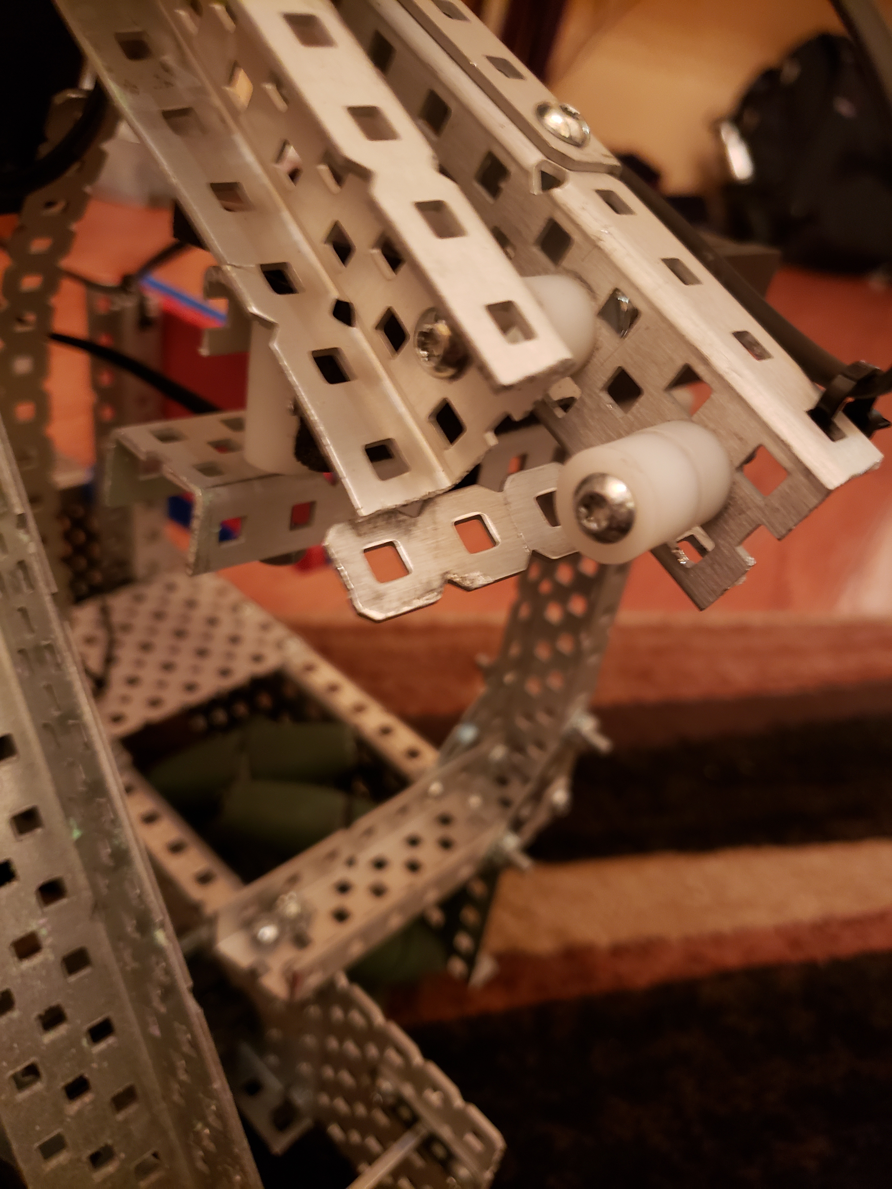

Hello all! I am having trouble getting a stopper that doesnt bend from force. I am currently using an aluminum bar. Any other ideas?: 20191023_190422 20191023_190417

Both a screw and a standoff only have one point of connection to the main c-channel. This is called a cantilever. I would recommend looking cantilevers up online because their advantages and disadvantages are highly applicable in vex. If you use screws/standoffs as stopper for a prolonged period you need to limit the force exerted on them. If you exert too much force on them then they will warp the main c-channel. This is a very common mistake, and it will permanently ruin the c-channel.
Judging by the photo, it looks like the hard stop is supporting your rollers. That means you need to support the weight of a motor and any additional force due to intaking cubes. From my experience, one screw/standoff will not withstand this application, and it could ruin your main c-channel.

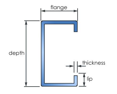

I would urge you to use a small c-channel as a stopper. If it does not fit, you should custom cut it to fit. Make sure that you have a minimum of two holes for mounting and the flanges are still intact. This will help distribute the force on the main c-channel and reduce any warping.
flanges

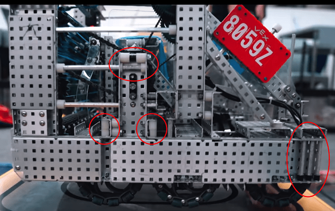

You can also reduce any potential warping by using a long screw which goes through both flanges of the c-channel. I don’t know if there is proper terminology for this technique, but here is a picture of 8059Z which demonstrates this.
bolting2
This is commonly referred to as a “box screw” or “box bolt” since they “box” the C-channel
