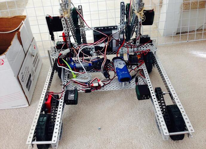

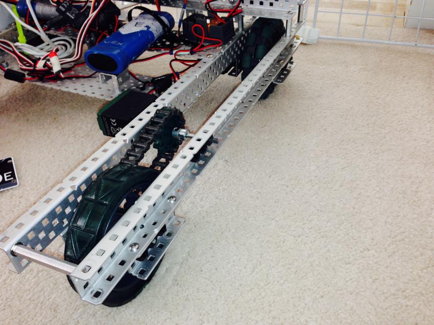

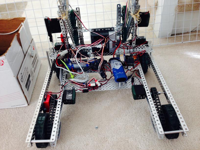

Our design isn’t particularly heavy. (Excuse the dog paraphernalia in the back)
My first reaction is that the drive needs more support, I only see the one standoff between the two C channels near the front. When the robot turns the chassis probably flexes and causes more friction on the axles. With the high traction wheels on the front you would notice this far more on the field tiles than a smoother surface. If you have some 1x5x1 C channel I would use that to connect the 1x2x1 c channels together, alternatively add several more standoffs between them.
I think we’ll out on some more stand offs and regear the motors for torque. I didn’t want to do that because we’ll be very slow; but i guess its necessary.
I’m assuming the robot is tank drive (correct me if I’m wrong) and if so having the omni wheels in the front and the high traction in the back seems to help a little more with turning. The onmi wheels generate less friction then the high traction wheels which could possibly allow you to keep the speed ratio rather than turning it back down to torque
