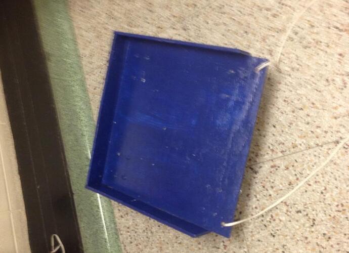

There are 2 parts - a storage box and a cart

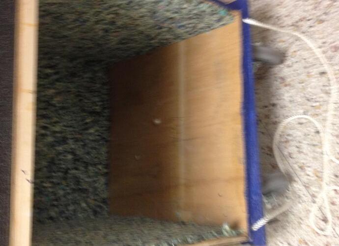

The cart has large casters and 3 sides so the box will not fall off but the door can still be opened while on the cart. The cart can also be used to transport the robot during tournamnets.

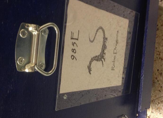

There is a piece of plexiglass on the side. This way the team can have the name/logo, but also change it year to year.
The bottom storage compartment is about 19 X 19 X 19. Big enough to store the robot but not too much room to move inside. it’s lined with carpet padding to provide some protection.

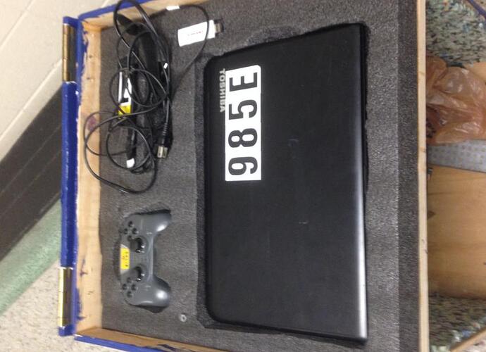

The upper area is kaizen foam with cut out for the lap top, vex net keys, controller etc.
Cool idea to put the foam on top for the laptop and stuff
