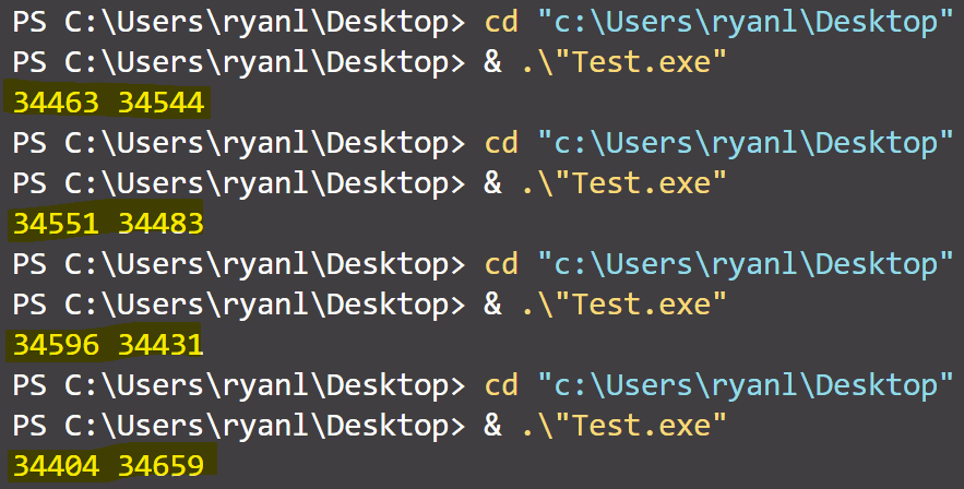

This is interesting, I seem to have received different results from you. My code is shared below. Essentially, person A makes the shot 20 times and the probability is calculated. For person B, 21 shots are made, and one of the results are discarded using another random number generator. The code is below if you would like to check it.

According to my result, it seems like person A and person B have results that are barely different. Upon simulating 100000 matches and recording the games won, it seems like they both win for around 34.5% of the times.
This does seem to be fairly similar to the win rate for Person A for your simulation. Did you consider the case where their accuracy is the same?
Your result also seems statistically incorrect to me. Theoretically, the center of the sampling distribution shouldn’t change even if you increase sample size. The center of the distribution should still stay at 95%, but the standard deviation should decrease.
