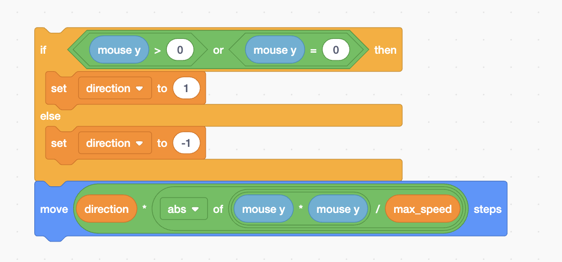

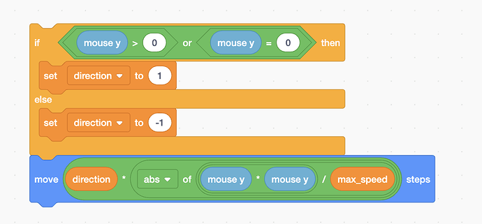

Now, in terms of code in blocks you just have to do some multiplication and division to the joystick value before sending it to the motor block. You can even skip the exponents by using repeated multiplication. Don’t forget that even powered functions cannot be negative. So should probably do all the math inside an abs value and then multiply by the sign of the joystick.

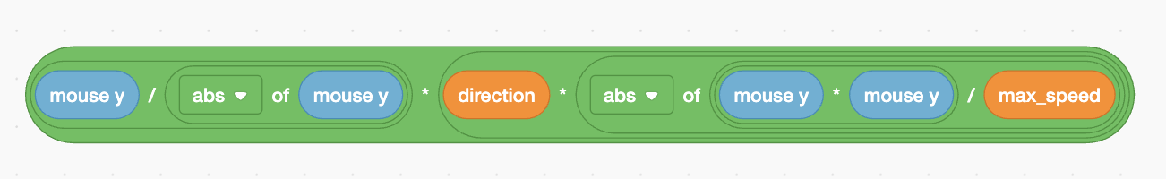

If I were using scratch and wanted to model the quadratic curve, it would look like the following. Note: max_speed must be the max value that the motor takes in. It could be 1, 100, 127 etc depending on which environment you are using.

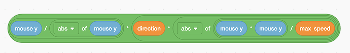

You could even one line it
