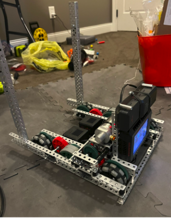

Usually, skirts refer to two plates on the sides of the robot, but in this case, you probably want them on the front and back. That is what we do:
Screen Shot 2023-04-04 at 8.15.54 AM
On the back of our robot we have a low bar to protect disks from getting under. This has worked very well for us on the past 3 robots, and also allows you to have a hard stop for wedges.
On the front of our robot, our intake is the width of our robot, and very low to the ground.

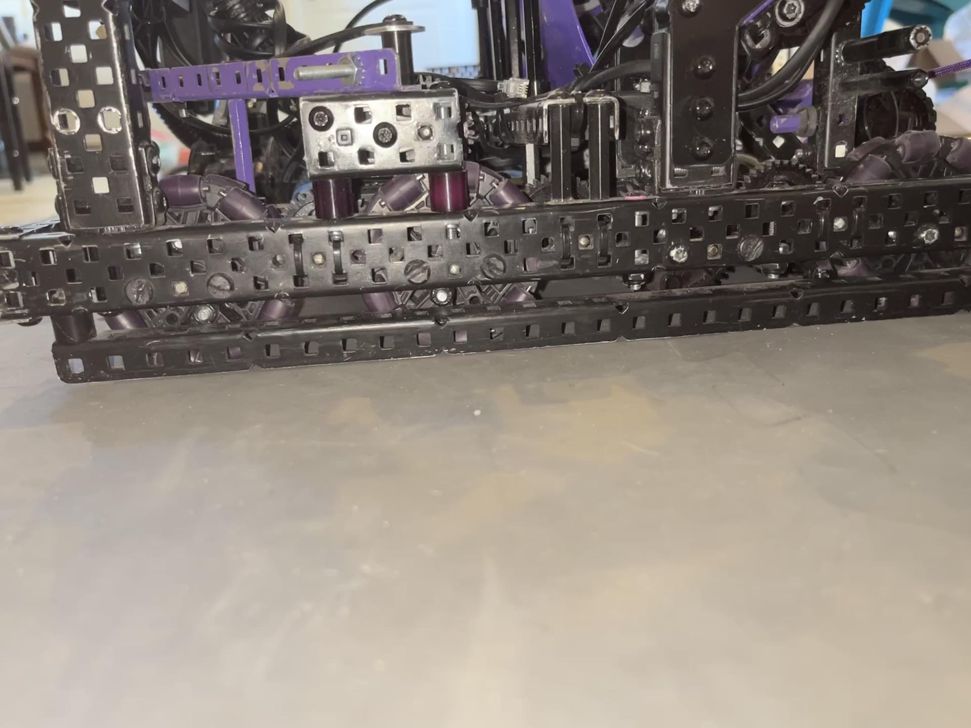

if you want a low skirt, you can attach a piece of L channel to the bottom of the drivetrain c channel. this will prevent discs from entering the sides of your robot.
here is how we did ours.
ben !
20 characters of love <3
Thank you Benn. It looks very nice!
Thanks for sharing the design. We will try that.
Benn, a question. If the L channel gets on a disk for any reason, is it easy to get off for you? Thanks.
