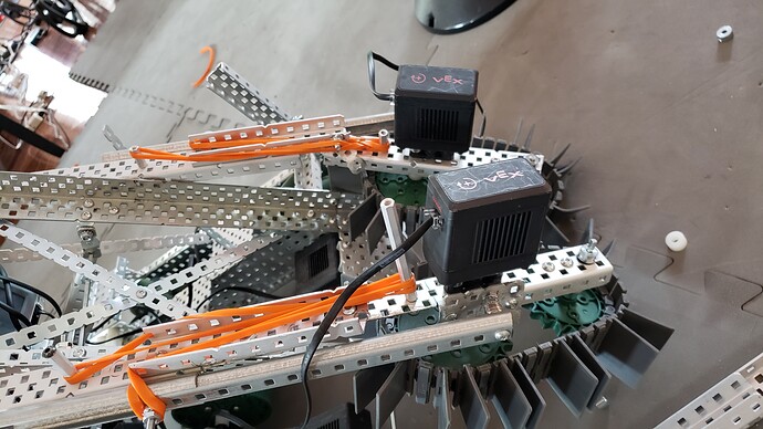

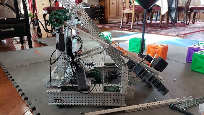

Good news. My robot works. Bad news. I need supports. Any advice of where to put them? Also, I need better support on where to put the support to keep the rollers right there.

I need supports anywhere it is needed for better strength. Edit: also the bar holding the intakes needs better support

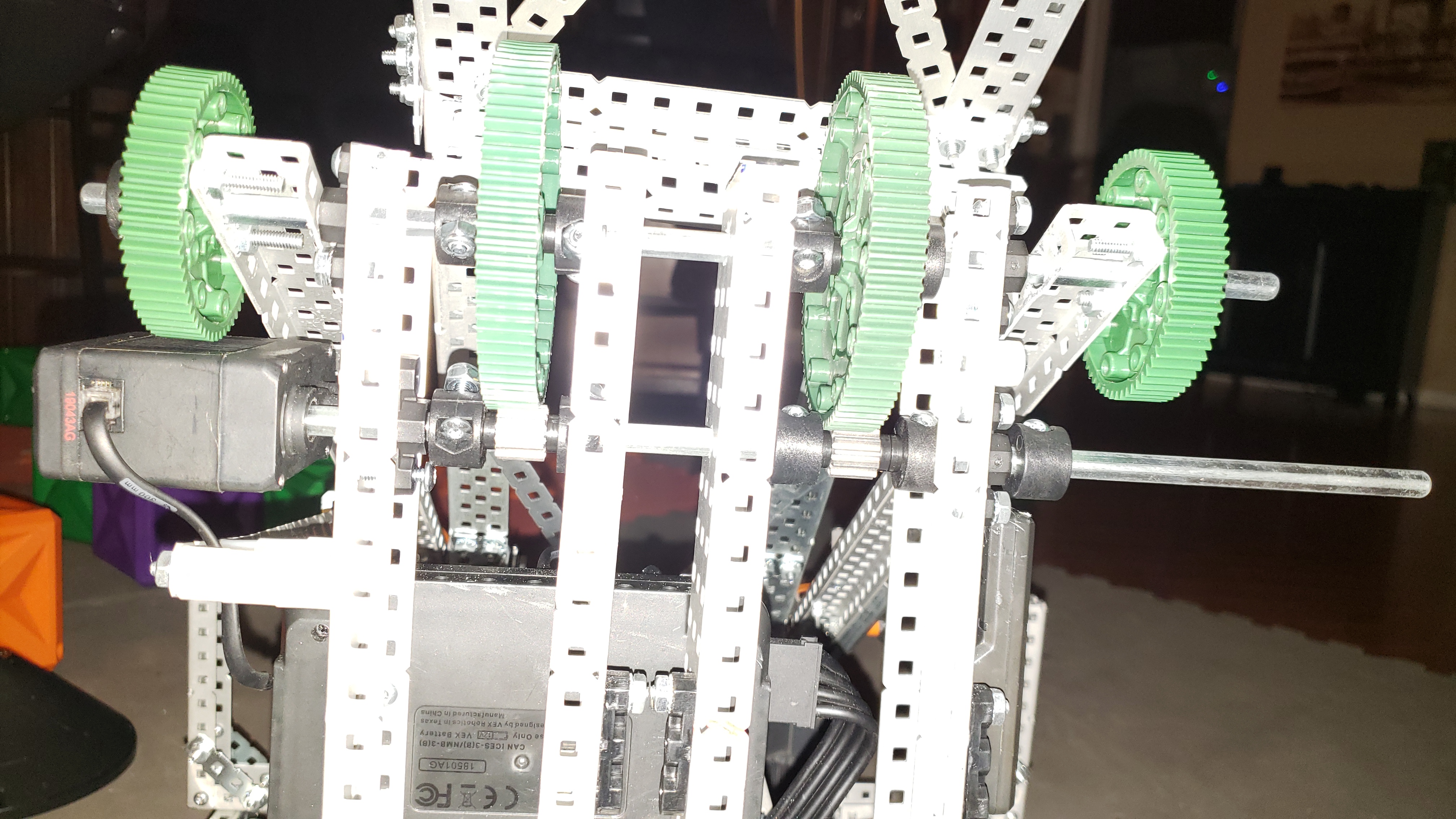

I would use x bracing on the bars with your intake. Also I would probably add another side to the tower supporting the arms to better support the axle.
@James6555 what do you mean by adding another tower? Also, this is my 2nd year in vex, so I don’t get all of the terms. By x bracing do you mean c-channels or bars in an x? Or should I add a 1x3 or 1x5 channel bridging across?
By x bracing I meant two bars going across in an x screwed together in the center, but other support could be done with c-channel’s going across
By adding another tower I meant adding another vertical c-channel supporting your axle that your gear is on.
@James6555 I currently have four.
Ok I didn’t see that so you should be fine on that front.
The bar holding the arms for the rollers up has very little support, and fixing that would be great. I dont have an idea for that yet though.
Another way you could x-brace a lift is to use 2 stand-offs that span the diagonal length between the two arms to form an “x”
