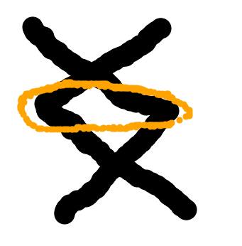

Why are you trying to add a suspension. Perhaps if you let us know more about your problem there will be an alternative solution. In most cases, rubber bands would work, have you tried to use higher quality rubber bands? If you have some space you could make something similar to an x-lift, like this:
It would have similar function to a spring
