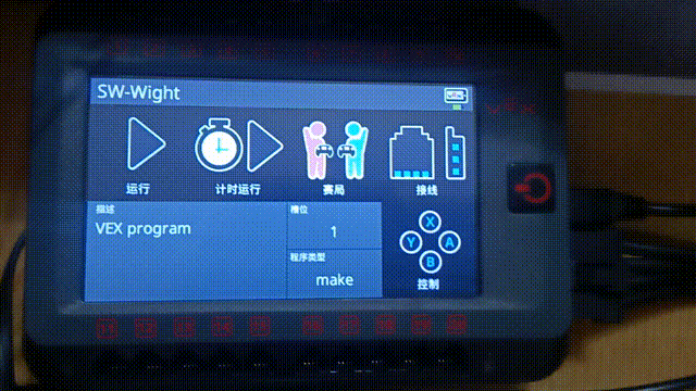

SW-Wight is a open-source GUI library based on the vex v5 system and V5 API. I only spend 3 days on this project, so there must be some shortages in this project somewhere. I’m glad to hear your suggestions. (〃‘▽’〃)
The SW-Wight contains 4 wights now. They are button, buttonGroup, Graph, Panel. And detailed api is directly written in the corresponding header files for you to check it out(^▽^).

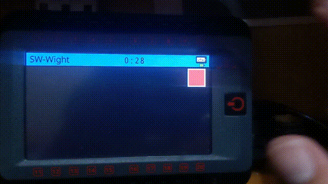

  1. button
    Custom color is supported.
    Custom size is supported.
    Two interactmode —SELECT and PRESS.

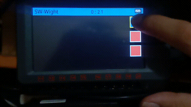

  2. buttonGroup
    Manage buttons by group
    Custom numbers of selected buttons
    For example:
    • One button selected ↓
      1ButtonSelected
    • Two buttons selected ↓
      2ButtonsSelected

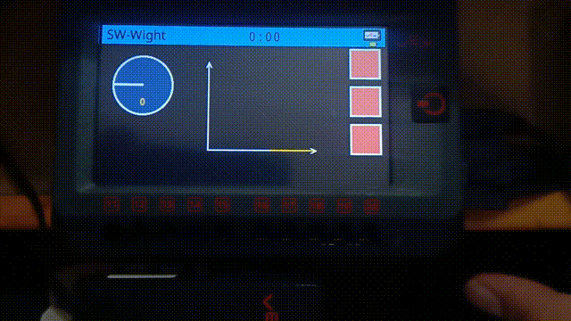

DEMO Reveal (All in one)
The Panel records the present motor velocity(unit is pct).
The Graph records the present motor velocity(unit is rpm).
If you press C1, a motor will spin at 25% of power.
If you press C2 or C3, the buttons you pressed will be selected.
If only C2 is selected, motor will spin at 50% of power.
If only C3 is selected, motor will spin at 75% of power.
If C2 and C3 are both selected, motor will spin at 100% of power.
However, if there is no button pressed or selected, the motorwill stop.

  1. The explanation is a kind of vague in the “DEMO Reveal (All in one)” part, due to the lack of definition of C1 C2 C3 (I actually forget to upload the picture). So here it is :
    BrainEdited
  2. Someone might get confused towards the interact mode (SELECT and PRESS) of buttons.Here are the gifs.
    SELECT:
    SELECT
    PRESS:
    PRESS
