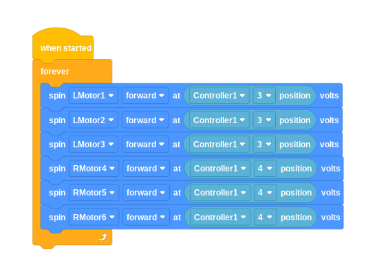

Ok so im having trouble with my 6 motor drive not wanting to… work when in autonomous mode. It drives fine when i do it manually but just refuses to move in auto. Can i use a different program for auto, then after auto ends, and during the scoring and such, switch to my driver program? Im still working to fix the issue and will till i get to worlds but still good to know about.

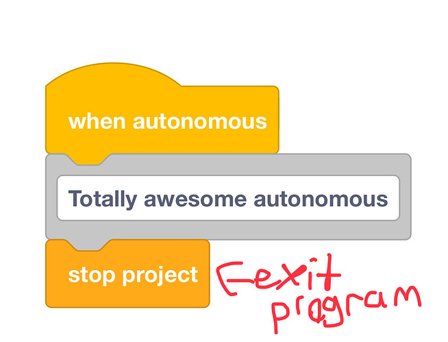

Yes, I believe that you could do this, as long as you don’t touch the robot directly. If I am not wrong, I think there is also a code function that allows you to exit the program. If you use this, then you can navigate to the driver control program using your controller once the autonomous program was exited.

How are you coding your 6 motor drive? If you coded it anything like the image shown below, then you might have the same issue I had. You have to have the drive system under the “when driver control” block and not the “when started” block otherwise it will obstruct your autonomous. If your drive code looks different than that, I have no idea what is wrong with it.
