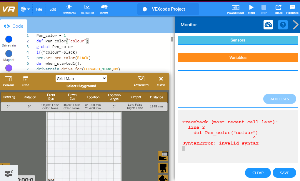

Syntax error in VEXcode VR
Pen_color = 1
def pen_color(“colour”):
global pen_color
if(“colour”=black)
pen.set_pen_color(BLACK)
def when_started1():
drivetrain.drive_for(FORWARD,1000,MM)
pen.move(DOWN)
vr_thread(when_started1())
This says it has a sytax error on the 2nd line. What’s happening

It’s incorrect Python, what do you want that code to do Milo ?
Im trying to get a function that I can just type in the color, or type random to get the pen as a random color.
I know both Python and Java
That can’t happen in Vex Vr code, that can only happen in the python app
In the function prototype, you should use the name of the parameter rather than a string, i.e.:
def set_pen_color_with_string(color):
    if (color == "black"):
    # etc...
color can be the name of a variable or function parameter, "color" is the literal string “color”, the two aren’t interchangeable.
yea, there seem to be some issues using set_pen_color inside a function, we will look into it.
ok, seems there is some issue with a function called “pen_color”, but this works
