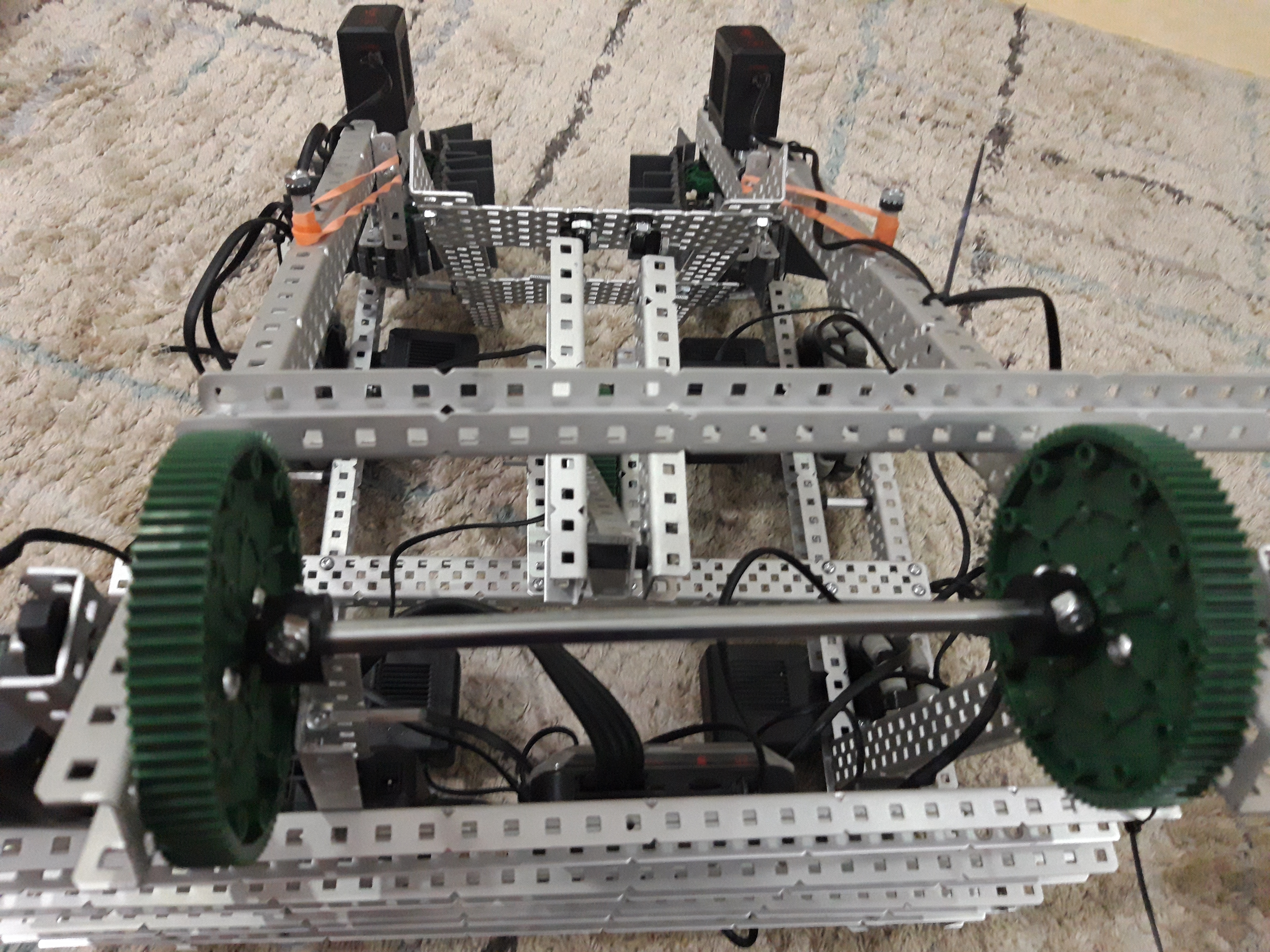

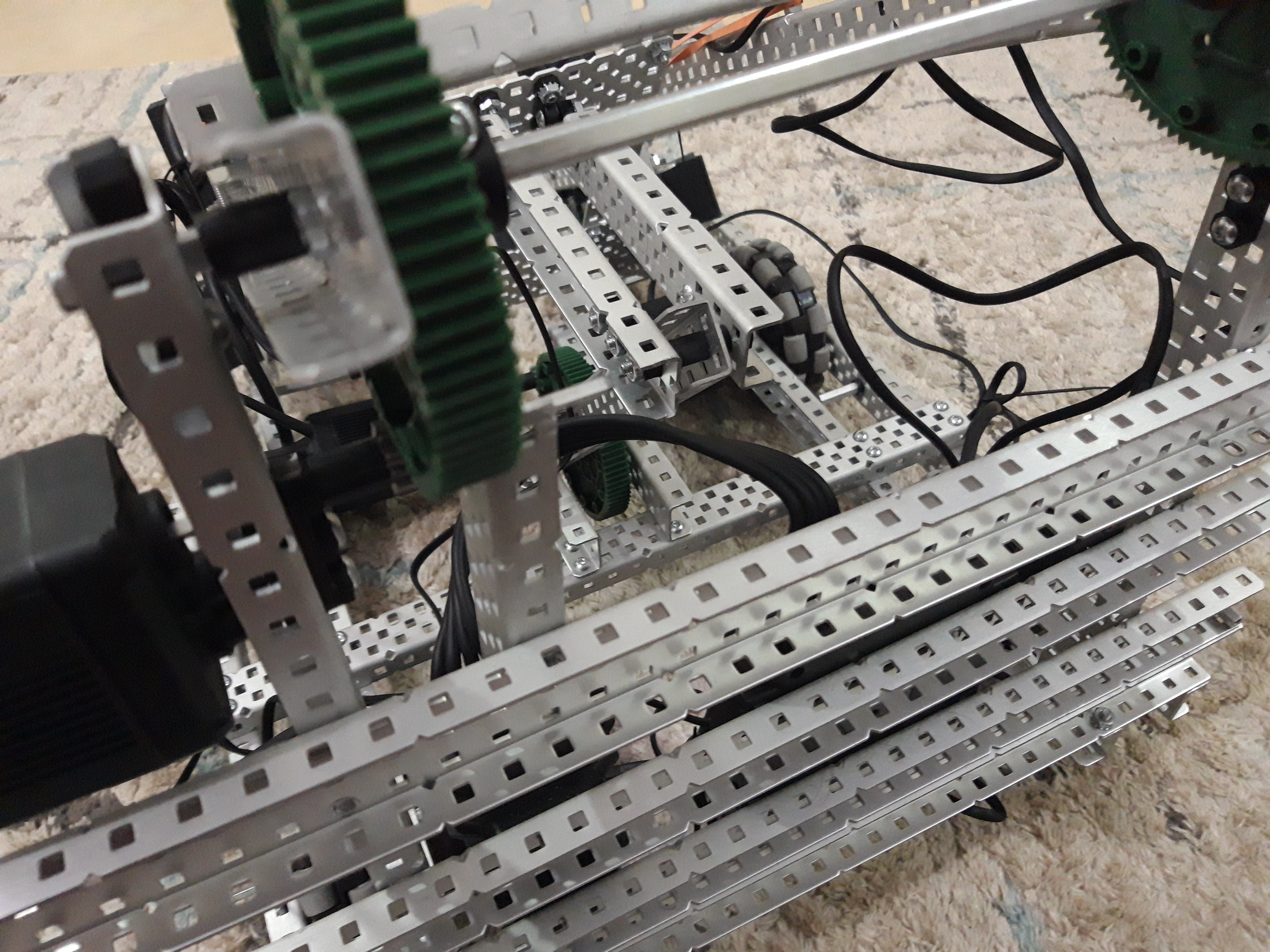

hi everyone,
I have a question, I used thick shaft with 84t gear connected to the ARM, 12t gear under the 84t gear ,the smaller gear is connected to thin shaft
motor is connected to small shaft
I tied to move arm up but it didn’t move
is it better to use two motors ?

Uploading: ٢٠١٩١٢١٦_١٦٢٣٥٥.jpg…
Thank you for this. Your problem is most likely that you do not have enough torque. I would suggest switching to a red cartridge and it would work perfectly. You could do this or gear it up even more, but i would advise against that unless you don’t have a red cartridge.

It looks like there is not a bearing on the metal supporting the shaft that powers the lift, I would add one there.
  1. unplug the shaft from your arm motor and see if the motor runs. If not there is an issue in your motor or code.
  2. unplug the shaft from your arm motor and lift your arm manually with one hand and hold close to the green 84 gear. If you can not lift easily, there is an problem of the machanic and building quality.

Thank you so much i changed the green cartridge to the red one and it worked
