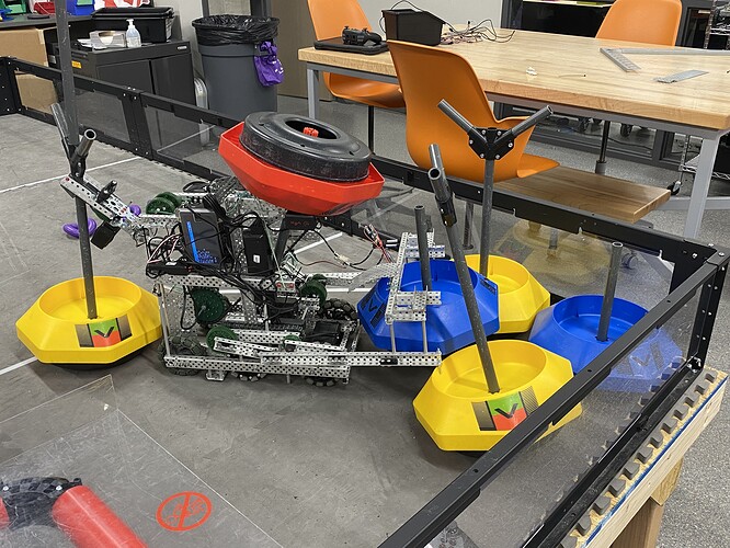

If you’re wondering what’s the problem of that, this makes this possible: (this is an exaggeration)
Yeah this is going to be a thing now.
I believe @Jon_Jack officially called dubbed this term “ramp camping” so this is what I will call it from now on.
So basically, from the photo, the robot currently “possesses” almost all mobile goals minus the blue alliance goal in the corner. Which is why “ramp camping” is possible. Maybe the GDC will probably update this to make this strategy illegal, but this will probably be active for the next few months.

I don’t think that strategy shown in the image is actually legal. The definition of possession in the game manual is
– A Robot is considered to be in Possession of a Mobile Goal if the Robot is carrying, holding or controlling the movement of a Mobile Goal such that if the Robot changes direction, the Mobile Goal will move with the Robot. Therefore, pushing / plowing Mobile Goals is not considered Possession, however a Robot using concave portions to control the movement of Mobile Goals is considered Possession
I might be wrong in my interpretation of this rule, but it seems to me that this robot would be considered “In possession” of the blue alliance goal in the corner. It is being controlled by a concave shape, the two mobile goals surrounding it, and if the robot were to turn in either direction, the mobile goal would be moved in that direction too, at least somewhat. Also, just because the blue alliance goal isn’t touching the robot directly doesn’t mean it isn’t being possessed. For example: robots that throw goals into a large container in the back. There may be a mobile goal that gets thrown in, but is entirely supported by other goals, and is in no way touching the robot itself. I don’t think anyone would say the robot is not in possession of said goal, so the same applies here I believe.
If they could prove to a judge that they are possessing (aka moving the goals through the transfer of energy in the robot) then yes, this situation is legal because only the blue mobile goal in the corner is hoarded.

There trying to say, yes there may be a “loophole” but we want compeitors to use common sense and realize that it is very difficult to write the rules without a small grey area being added. And to realize thats probably not what they meant
If the team can verify that if the robot moves, those goals move with the robot, then yes, they would be in possession by said robot
Actually this got proven that it was not hoarding by the actual person who made the picture:
Sorry for the late reply. The picture in question shows my robot in legal possession of 5 goals and it is also hoarding 1 goal. Effectively, this locks down 6 out of 7 goals. The two yellow goals are held in by a long screw, and they do meet the definition of possessed.

depends - if the robot loses control all the time with the two screws, then not really in possession.
