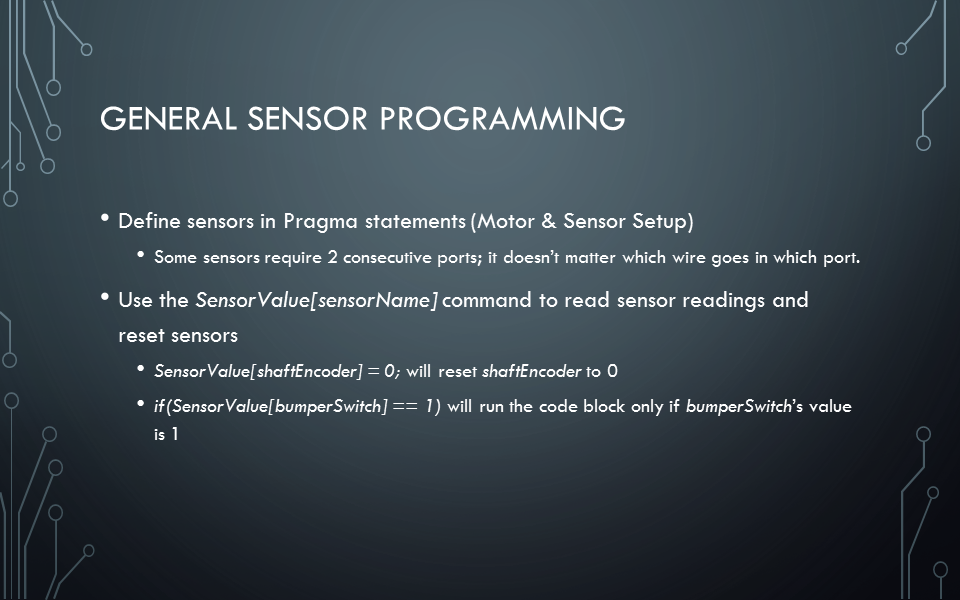

I attached 2 slides of a presentation I made a while back on the basics of sensors and RobotC. With some tinkering with RobotC and the sensors (and my brief overview), you’ll probably be able to figure out most of what you would need to know. Also, the sensors’ product pages often contain some useful information. For example, the optical shaft encoder’s page’s Programming Resources tab has RobotC sample code.
Feel free to post here or PM me if you need additional clarification/information on something.

So I suggest just reading code to get an idea for how everything works. Programming is really a skill best learned through reading code and just trying to write your own code. ROBOTC has a lot of example programs you can find in file → open sample programs.
Once you know how to read a sensor
sensorValue[encoder]
and you know to command a motor
motor[drive] =127;
and you have a basic understand of program flow it isn’t difficult for you to understand how to write something like
while(sensorValue[encoder]<1000){
motor[drive]=127;
