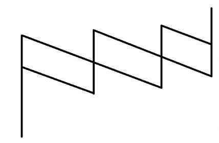

I would have thought an 8 bar linkage would be something like what I made (very professionally, mind the high quality ;)) in paint below.
https://vexforum.com/attachment.php?attachmentid=5041&stc=1&d=1321511839
~George
look at it sideways, its just a scissor lift :slight_smile:
Yes, something like that. Of course, this is just the same as what Jij posted above, except with a couple of redundant joints and longer metal pieces (which I suppose could potentially make it more stable).
Yeah, it really is just like a sideways scissor lift.
do you give paint lessons Jij? I am impressed :stuck_out_tongue:
It looks like the same thing but with another set of joints.
