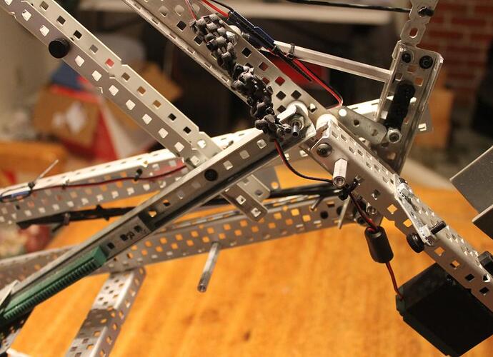

https://vexforum.com/attachment.php?attachmentid=8165&stc=1&d=1395092251
When the lift is down, the difference between it and more standard robots seems trivial, I think most of the scouts that came by the table missed it, but it has an…er…twist :smiley:
I see something twisted around an axle just above the back of your tray, which would be my first guess at what the “twist” is, but I can’t imagine what it does.
Your cold but not quite frozen.
Why is there an axel on the back of the intake tray?

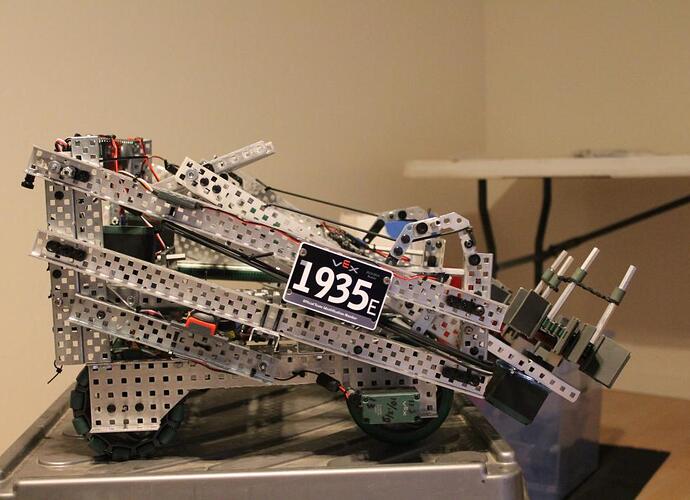

Teaser #2
A view from the side.
https://vexforum.com/attachment.php?attachmentid=8167&stc=1&d=1395114683
Is it capable of removing Bucky balls from the stash?
Well the first thing I noticed was the absence of motors directly powering the four bar and the two motors facing downward in the back are interesting…
It could remove a bucky that was partially above the tube but not as well as more standard bots.
Also note that this robot carries over many of the traits of it’s predecessors (links to their respective reveals in the first post)

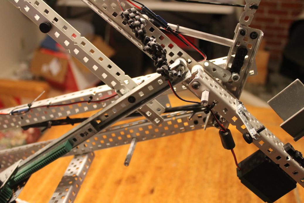

I feel like posting another picture so here goes.
https://vexforum.com/attachment.php?attachmentid=8168&stc=1&d=1395117160
And yes that is a lawn chair in the background :rolleyes:
You are one of the most exceptional teams in the state and should have been there this weekend. Could we see a video of this beast? :wink:
My team has been watching your teasers/reveals all season and had the honor to compete with you at both the SLO and Tracy tournaments, and we have always been impressed with what you have had to offer. You and your father are always very friendly and you always have the best designs. I won’t give anything away about your robot, but I do have to say it was pretty cool when we last saw it at Tracy :slight_smile:
Im assuming that the cage has a “dump truck ability” around the back axil. This is seen clearly in the last photo were the cage is know were to be seen
Nice rack and pinion lift…:slight_smile:

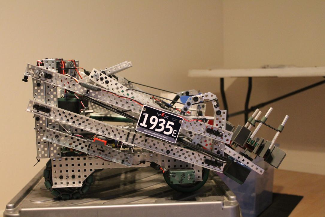

Correct, here is a pic of the dumping mechanism
https://vexforum.com/attachment.php?attachmentid=8169&stc=1&d=1395169448
I like it because it takes a lot of stress off the lift and provides a more even lift speed.

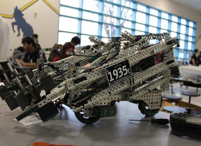

The robot resting between matches at Tracy:
https://vexforum.com/attachment.php?attachmentid=8172&stc=1&d=1395171565
Very pretty robot :smiley:
