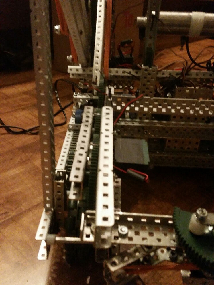

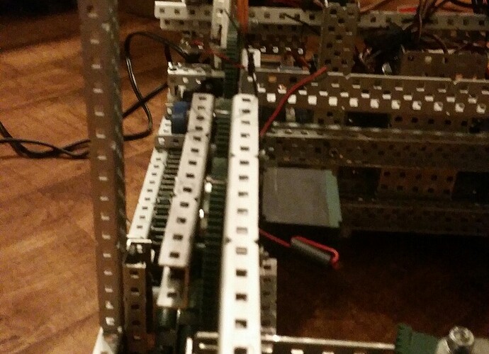

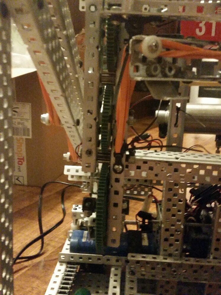

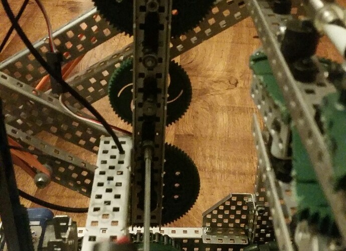

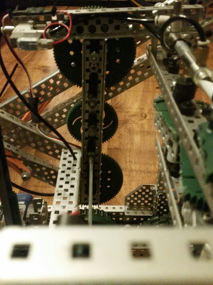

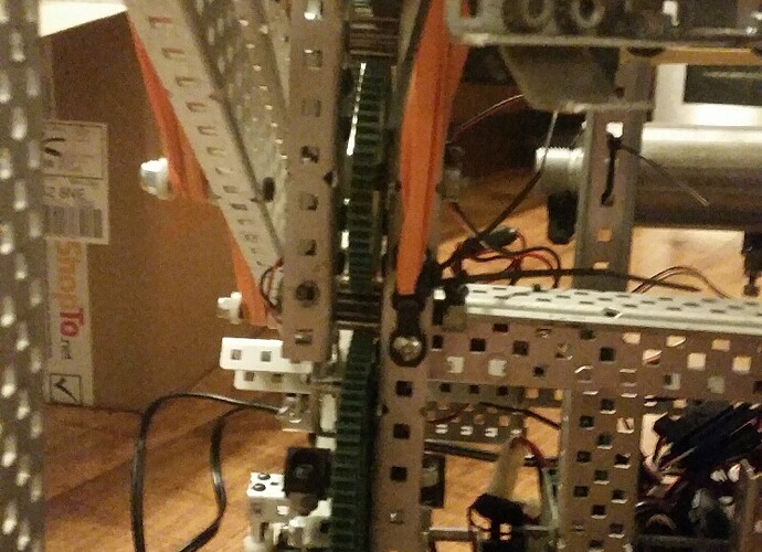

It’s Kieran from Team 3116A, The United Kingdom. I am writing this reveal because I have come up with a new lift design, one that can be used in this season. I have decided to call my new design, ‘The Gearbar’ because of its similarities to a Chainbar and a 4 bar, however quite obviously, it uses gears!
The Gearbar works by having 2 pieces of metal which are fixed to gears of any sizes, and then having an odd amount of gears between them, this is how you can make ratios with it. On one fixed Gear you will have your intake, (A) and your other, a tower or end of a lift (B). They allow for internal stacking due to their motion and that is what we use them for. By powering the middle Gear(s) (C) the bar pivots around gear B in a circular motion. My team has a competition today so we will add some videos of how it is tonight (Roughly 12 hours). Here are some pictures…
Any contribution the VEX community could give would greatly help the development of this design.

Someone correct me if I am wrong, but it appears to me that they have just replaced the sprockets and chain in a chainbar with gears. The bottom gear is stationary, and that results in the last gear being stationary. It is just a chainbar that was made in a different way.
I would also be concerned with the slop in the gears adding up if you made this much longer.

What are the advantages? Seems to be heavier, and also a waste of gears when you can use a chain.
Slop and space
i guess it works better than a chainbar for high torque applications but at that point why wouldn’t you just use a four bar

In the spirit of wanting to contribute rather than just knock a great idea, I think this is totally workable. There are a couple of things I would suggest, though. I would replace the gears at the end with sprockets and replace the gears in the middle with chain. You can accomplish the uneven movement you want by using different sized sprockets on the ends or keep the orientation the same by using same size sprockets. You could come up with a clever name for it like chain bar. I think with those minor modifications, you will be on to something. Good luck and keep innovating.

I don’t think we’ve seen any videos of the system, but it’s very straightforward to imagine, particularly if you have experience with a chainbar.
Imagine the two sprockets at either end of the chainbar are replaced with gears. As I’m sure you’re aware, the sprockets are the same size. So to are the gears you put in place of the sprockets.
Now, instead of using a chain to synchronize the rotation of the two end sprockets, use a gear train* to do the same thing to the end gears. That’s it.
*One special rule when using gears for this: the number of gears between the two end gears has to be odd. That is so the two end gears will be rotating in the same direction.
