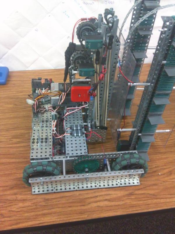

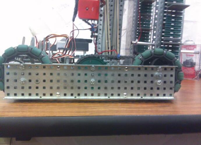

Drive:
-The drive is all wheel drive at 160rpm using all 4 393 motors.
-The robot is not pushed around very easily
-4 4" omni-directional Wheels
-1:1 gear ratios

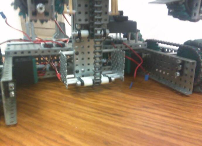

Lift:
-The lift is tilted back at about 3 - 5 degrees to relieve unneeded stress off the slides
-The lift is a double extending lift using an idea perfected by team 1103
-Uses rubber bands to help counter act the weight of the intake
-Uses 4 269 motors approx. 30 in lbs of tourque
-Very fast and light weight ( not sure on time but its around 2 - 3 seconds to 30" goal

2-3 seconds is a great speed for an elevator lift with 4x269 motors!
Have you ever had overheating or cracked internal gear problems on the lift?

Why are the lift motors mounted high instead of low?
I usually like to mount my outside C rails with smooth side out,
and I like to use something more substantial than just standoff-posts to mount the outer rails.

No i have not had any problems at all with cracked internal gears or over heating problems

Any wobble in the outer rails?
Any lock-nut slightly loose issues?

Nice work, good to get an elevator that quick… How light is your scoring mechanism?

i would say our intake weighs about 1 - 2 lbs… its not very heavy but we use rubberbands on the lift to help counter the weight
