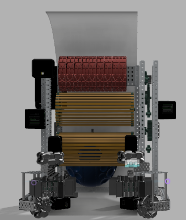

This is my first design for this year. Sorry I skipped out on some of the smaller parts and details but this is basically what I plan to build
it has the trap door on the back with the motor powering it being the same as the flywheel using ratchets.
Also what are you guys thinking when it comes to hoarding balls this year?
Ignore the number of wheels :smile:

Um… I think you should reduce the number of wheels on your flywheel. That’s a lot of unnecessary weight
:smile: ik i was just kind filling up space ill probably just have 2-4 on the actual robot

Can I get a close up on that rachet? No offense, but It looks a bit convoluted. Other than that(and the wheels), it looks pretty nice.

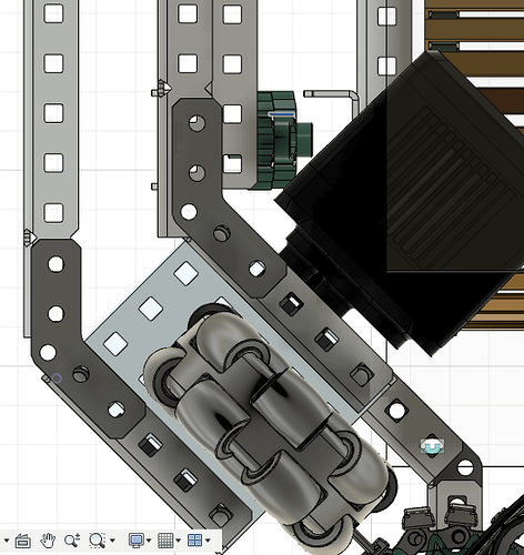

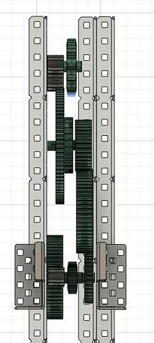

yeah here you go I haven’t put in axles, shaft collars or the custom cut up BS needed for the ratchets but I used 2 different ratchet designs. Sorry for the jankyness first design only started 2 days ago :smile:.

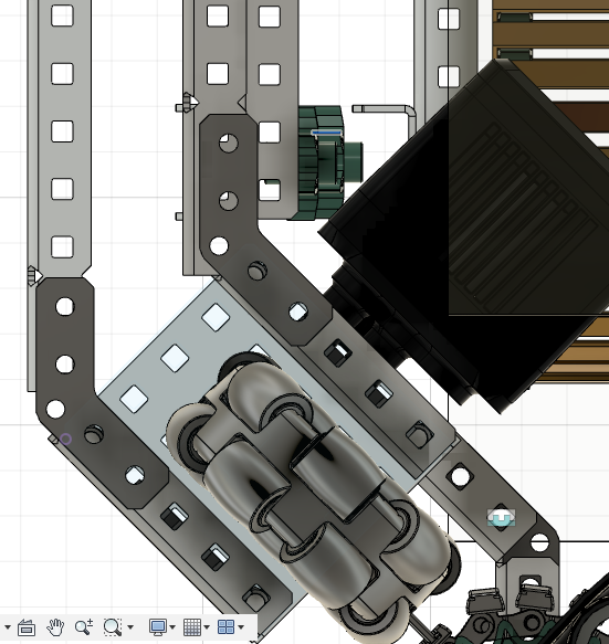

also the wheels are kinda weird so basically i wanted the chamber the wheels sit in to be 5 holes apart and had to attach the 45 angle gusset weirdly using the middle hole and am going to have to use standoffs to keep the chassis sturdy also to make this work you’ll need to file down some of the c-channel. Ik there is probably a way better way to do this but i have a long time till the season starts so.
You are definitely going to want to find a good way of supporting that. I know from experience that supporting that important with just 1 screw will not turn out well.
thank you. i’m thinking 2 stand offs in between the sections but if that doesn’t work ill just go back to a standard x-drive design and make things work out another way.
