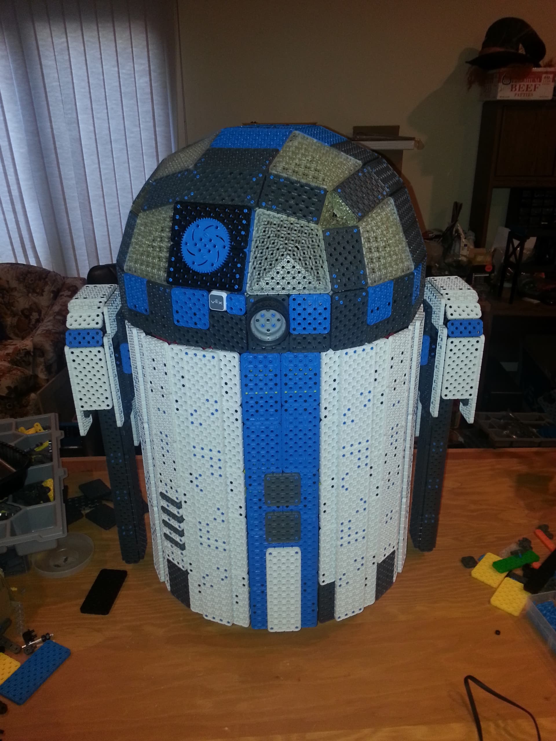

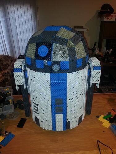

I’m going to guess this is not exactly what you’re looking for, but maybe some have not seen this. I had a friend 3d print some parts to make the head on my life-sized R2D2

Wow, that is amazing. Does it move and the “head” spin around?

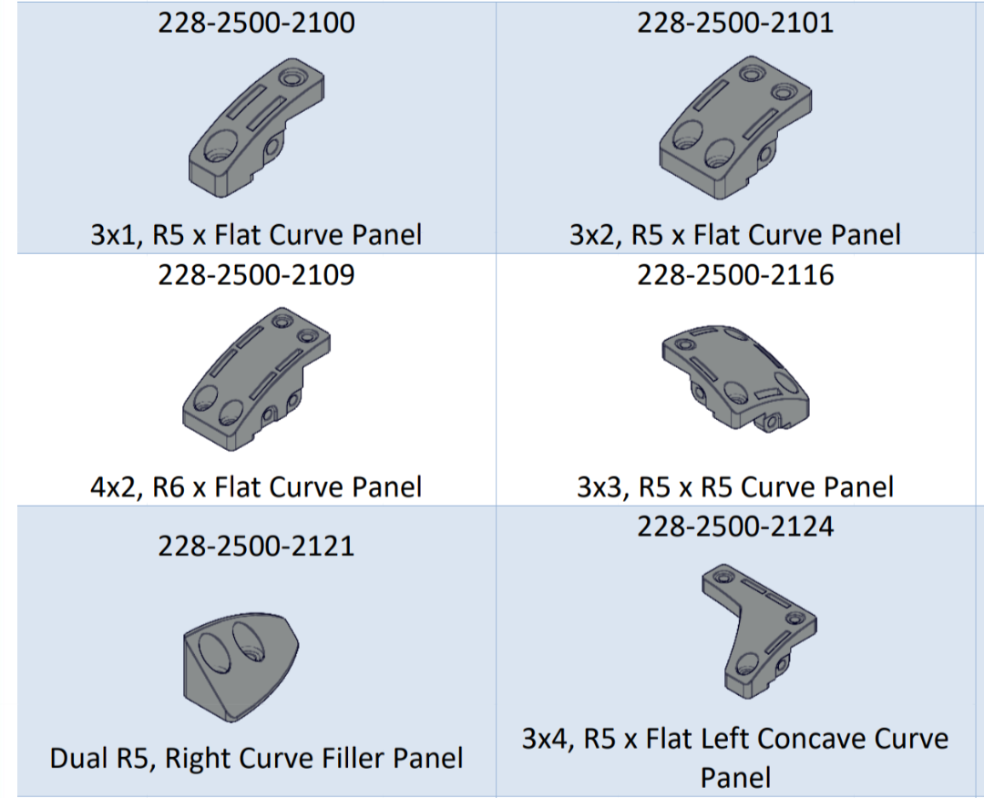

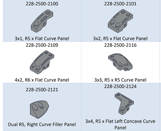

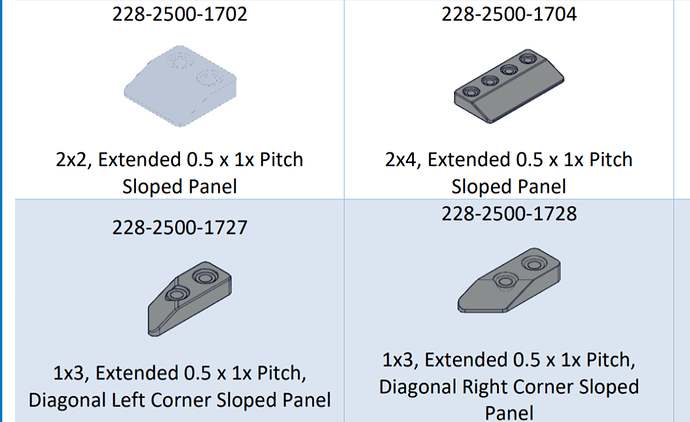

My kids always find the below pieces useful every season. It’s their problem solving pieces to guide field elements into certain areas in their robots and jam prevention pieces.
And of course metal axles, capped axles, and metal motor axles are a must for them for reliability.

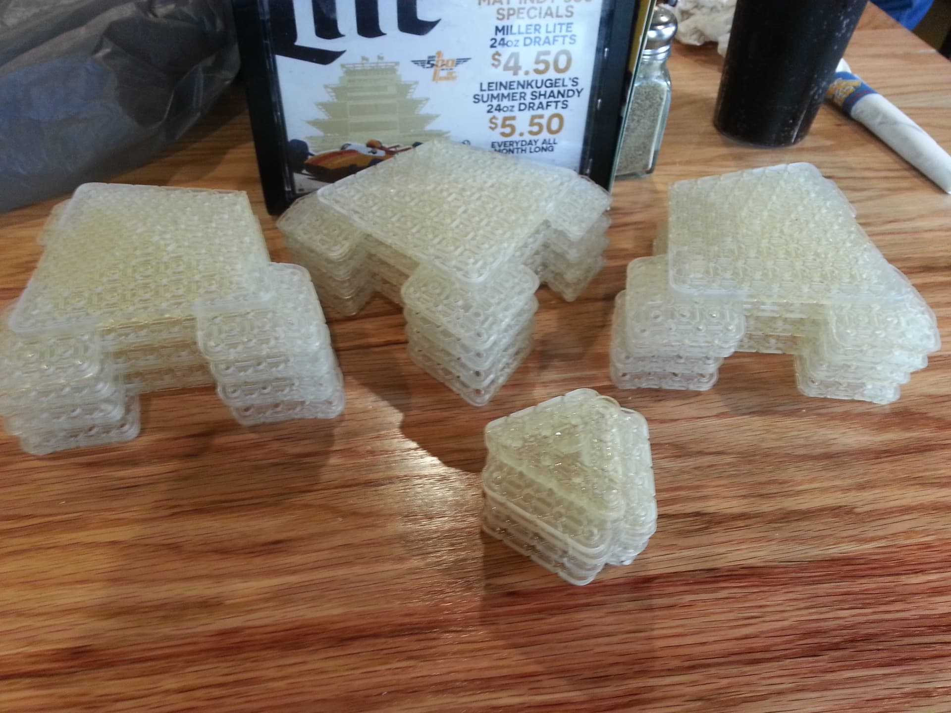

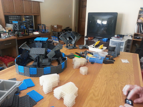

I just realized this video is already seven years old.
Thanks for the video. I didn’t know that there were plans available for the 1/3 sized model. With all the plates from Slap Shot, I should have enough to build it. They appear to be gone, I’ll reach out to Damien Kee to see if they can be put back on-line.

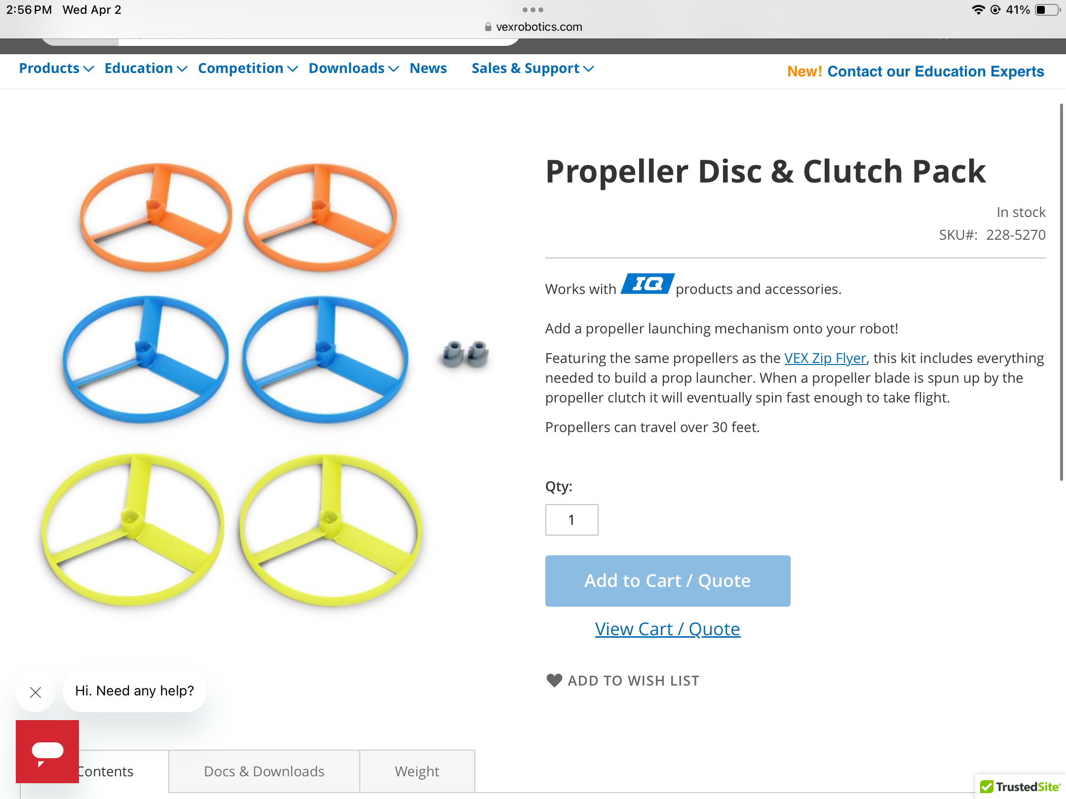

BOW DOWN TO THE SPINNERS! THE MOST AWKWARD PEICE

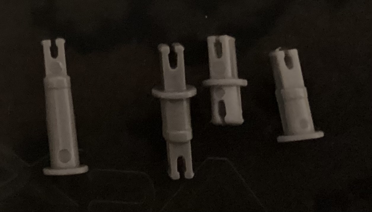

Allow me to introduce you to these four agents of chaos (appologies for the blurry photo:
Whats so wierd about idler pins?
They are useless to connect two beams together? :thinking:
I think they are awesome, they really make it easy to create custom gear trains. The capped ones are great, the 0x2 capped version (far left) is my goto in most cases. But the real hero of that family picture is the 1x2 idler pin (second from the left). It’s a quick way build compound and or compact gear sets. They come in the differential gear set with a number of the Double 2x Wide, 2x2 Double Offset Corner Connectors that make chassis builds go super fast.
One of the sadness in the idler pin family is the 0x3 from VEX Go. It’s got the “weak” connections so I don’t trust it for other than prototype work. I know that there shouldn’t be stress on idler gears, but I’ve been around since the burgundy pin days.
If used properly, there isn’t anything wrong with them.
However, they incite poorly cantilevered wheels. When I first got into VEX IQ, I thought they were meant for exactly that. I’ll leave it up to your imagination to see how that went. All I’ll say is they look too much like axles to the beginner mind.
All in all, they have their uses, like every other part, but they sure do promote some pretty awkward situations.

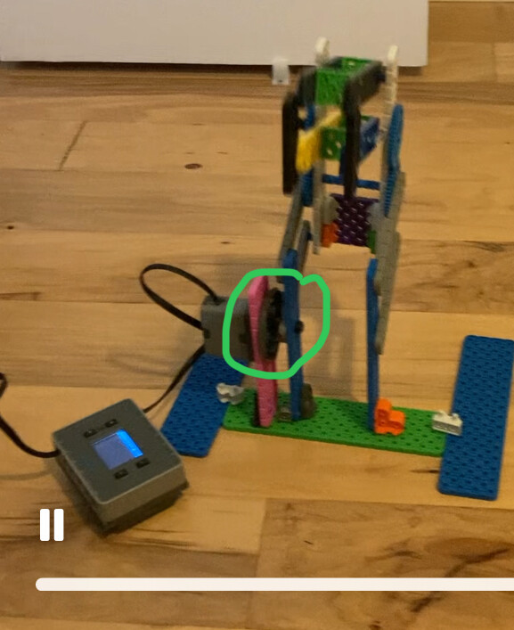

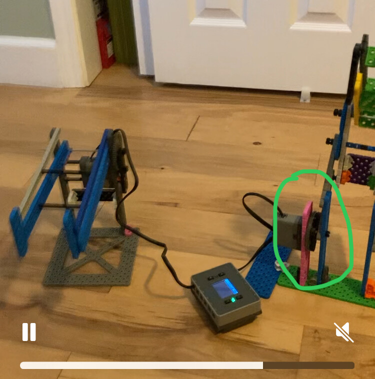

My son’s team likes the planetary gear pieces. They only ever use it in a configuration with the ring gear locked, but running the sun gear and outputting via the planet carrier is a compact, sturdy 4:1 reduction in speed with corresponding boost in torque. My son has been able to use a single motor to power a fairly heavy double-reverse 4 bar lift (which his team may use in Mix and Match this season). My son also built drivetrain running the planet carrier off the motor and outputting to the drive wheel - nice gain in output speed. He zooms this around the house banging up our floor board trim. The only issue with sun as output is the normal wheels (omni, etc) are the same diameter as the planetary assembly so need wheels with larger diameter if using in this fashion.
My son built two arms to get an idea how they function irl. Planetary gear circled in green.
