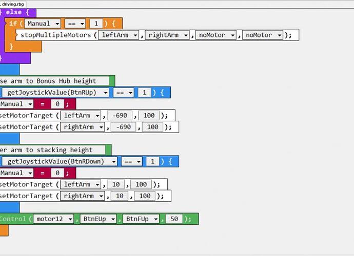

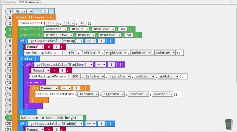

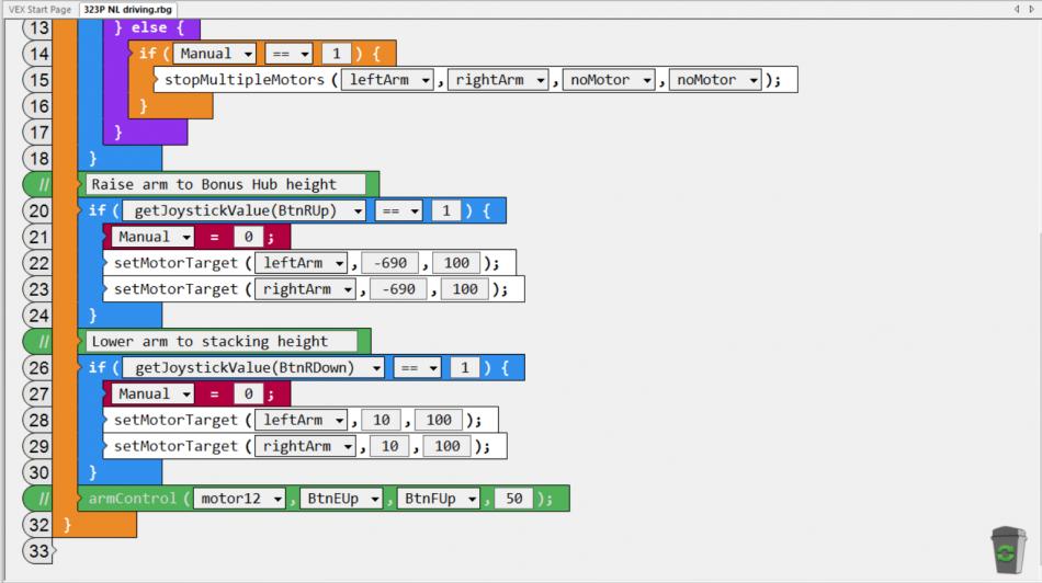

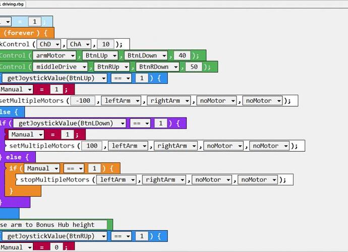

Here is what my daughter uses for her team. She uses BtnLUp and BtnLDown for manual control of the arm and BtnRUp and BtnRDown for automated control of the arm. A “Manual” variable is used to tell whether the last arm control was using a manual button or not. This is needed in line 14 to determine whether or not to stop the motors. The automated control uses setMotorTarget, so stopping the motors when in automated mode would defeat that purpose. The first screenshot show includes the manual arm control and the second shows the automated arm control.
Hope this is helpful.

Manual is a variable. She used a “Variable [Number]” block from the Variable section.
